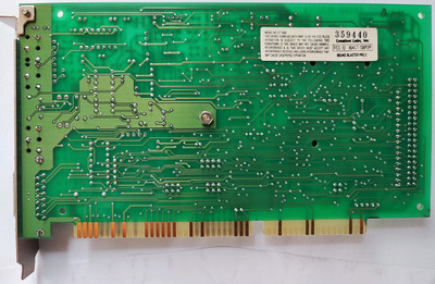

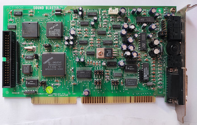

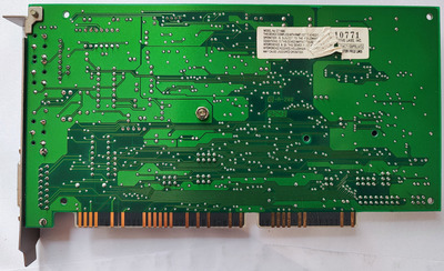

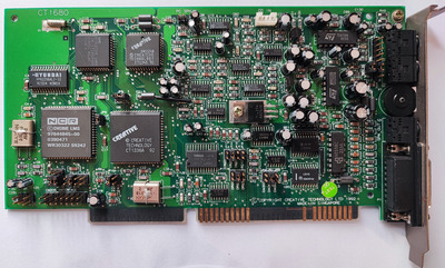

Reply 23 of 25, by aitotat
Here are better pictures of the CT1600 and CT1680 if someone wants to do comparisons.
CT1600 rev 4
The attachment CT1600_front.jpg is no longer available
The attachment CT1600_back.jpg is no longer available
CT1680 rev 1
The attachment CT1680_front.jpg is no longer available
The attachment CT1680_back.jpg is no longer available
Reply 24 of 25, by shevalier
aitotat wrote on 2023-04-24, 10:35:
