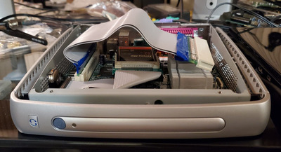

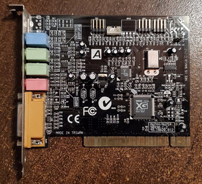

Hi. I'm interested in using this card with my HP thin client, but in worried about compatibility. I've had a lot of trouble getting any of my Yamaha PCI cards to behave with this system.

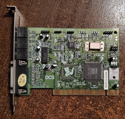

My YMF724 breaks the keyboard, both USB and PS/2. It just stops working, and there is a screeching sound that comes from the onboard audio when the system is powered on. The YMF744 doesn't break the keyboard and doesn't have the screeching sound, but the BIOS doesn't assign it an IRQ and so it can't work in either DOS or Windows.
I'm not sure what the issue is with these cards and this particular platform. I've had mixed luck with some other cards but most of them work, such as the ESS Solo-1.
Are you familiar at all with these problems or why they might be occuring?

Kahenraz wrote on 2022-05-28, 06:17:
Hi! Not really. But thinking that our sound controllers will be behind another PCI-PCI bridge, so the actual behavior may be different from the one you've experienced.

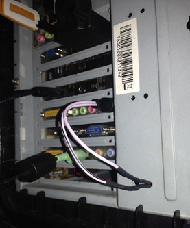

I did digital out on vortex to digital in on XG
Initial impressions are IRQ and resource nightmare, but its doable on Asus p4p800se reserving IRQ 5 and 7 in the BIOS helped. I assign SB emulation for the vortex on IRQ5 and Sb emulation for the XG on IRQ 7.

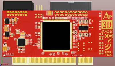

Hello everyone,
I guess you thought that Fortex was on hold but not yet!
We've been sorting out some minor bugs, and just ordered a new prototype:

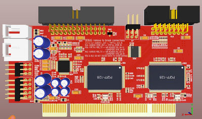

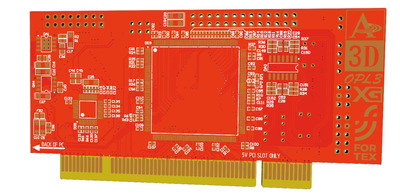

139.99 KiB
2082 views

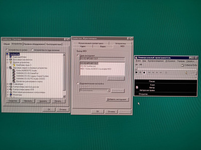

So far we are stuck with only one major issue - when we choose YMF744's external MIDI in the Win9x multimedia applet and try playing anything (i.e. sending any MIDI command), the player stops responding. We need this function for the wavetable header, and haven't come even close to understand the cause of this behaviour, it just hangs no matter if daughterboard is there or not, or if the AU8830 part is enabled or disabled:
174.66 KiB
2082 views
Video: https://drive.google.com/file/d/1tp_u_SCRDVZ0 … iew?usp=sharing
We've tested the same thing on a regular YMF744 card, no issues at all, working as intended.
So far our two hypotheses are:
1. We've got somewhat faulty YMF744 chips - will be tested on the next prototype by soldering a tested chip from a working donor card.
2. YMF744 MIDI controller/driver does not like sitting behind a PCI-PCI bridge - we need some help from the community to test a regular YMF744 board on any period correct server/workstation motherboard that has a secondary PCI bus derived from an Intel/TI/DEC PCI-PCI bridge chip. For example, an Intel L440GX+ will do perfectly. Anyone willing to help out there?
