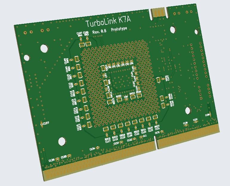

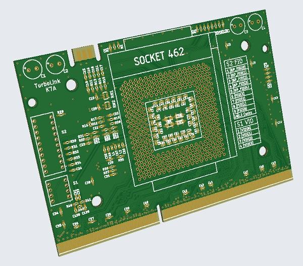

Well, this is a project i've been working on for quite a while now, a Slot-A to Socket-A adapter. This is currently revision 0.8 (the 7th major redesign) and i hope to be able to make the PCB order this weekend:
open-drain_pr1_front-jpg.883715open-drain_pr1_back-jpg.883716
It should support CPU's all the way to the later Barton-based Athlon XP's with some bios modding for additional CPU support. It's got some dipswitches for Vcore, Multiplier and Cache control. (Multiplier/Cache control requires connecting a few L bridges on the CPU) There are AM4 mounting holes as well for better cooler compatibility, water blocks in particular. This is kind of a learning project for me to get more familiar with complex/high-frequency PCB design and it combines nicely with the retro-hobby.

Wow, that's amazing! Nice job!
I will say though, Slot A boards are pretty hard to come by compared to Socket A boards.

That's a valid point indeed... But 800mhz+ Slot-A cpu's are also becoming pricey and hard to come by. For reference, i have 80 Socket A cpu's and 1 Slot-A cpu. (and 4 Slot-A motherboards...) I could go above and beyond to find a 1GHz Slot-A cpu but then it's only usable on my Slot-A boards... Or use a slotket and have a large amount of Athlons to choose from that can still be used in other boards. And it's kinda nice to just have some new stuff to mess around with, maybe building a nice competitor for the Slot-based Tualatin systems with something like a Palomino based cpu.

Yeah, it's definitely an interesting project. Slot A CPUs are pretty abundant compared to the motherboards, but anything above 700Mhz or so tends to be quite pricey, and anything over 900Mhz is rare. I would be interested to see how a later model Athlon XP runs in an old board if it's possible. Though I would imagine that you'd be limited to 100Mhz FSB, since the slot A chipsets never supported 133 or higher. If there was a way to get it to support the proper voltages for mobile Barton chips you could get a 16x or 16.5x multiplier and 512KB of cache with very low temperatures. That'd be a pretty cool setup. 😀
Reply 24308 of 27575, by Minutemanqvs
That's a super amazing project indeed! I hope it works in the end 😀
