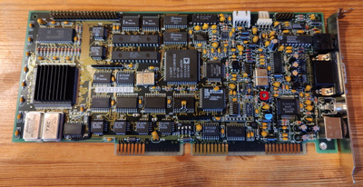

Hello everyone,
I got this ISA MPEG1 decoder and would like to run it in my 486 system.
Unfortunately, I have not yet been able to find out the name of this card to look for a driver.
The chip beneath the cooler on it is the Winbond W9920A-1.
I found a driver for a "True Magic" card that uses the same chip, but it was obviously the wrong driver. The IO addresses did not match to the avalible dip switch settings.
By the way, the burst tantalum capacitor in the picture has already been changed 😉
I would be very happy if someone recognises the card.
Greez
Markus

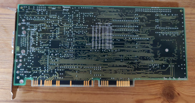

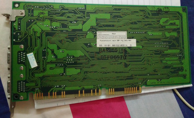

Reply 1 of 37, by RaVeNsClaw
Sadly, I still had no luck finding out anything about this MPEG decoder card.
It's not PnP and there is no ROM to read.
There are two logos on the board I don't recognize:
51.12 KiB
2139 views
74.69 KiB
2139 views
The first logo looks like the runic character "ehwaz", meaning "horse". 😉
There are also two part numbers:
VER: C2 PN: 3502401000
MM941031P
The second one is probably just the manufacturing date, as the PCB date is 9437.
With at least a company name I could do some investigations in the wayback machine...
Greetz
Markus

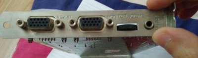

Reply 2 of 37, by weedeewee
No help on the name but from the listed vga pinout on the back I get the impression that you'll need a sort of splitter cable that attached to the card with one end going to a vga monitor and the other end going to the vga card.
also, did you buy this card on ebay recently, since that seems to be the only fast google reference to anything about this card I can quickly find.
also, which Truemagic card were the drivers you found for ? complete name(s)

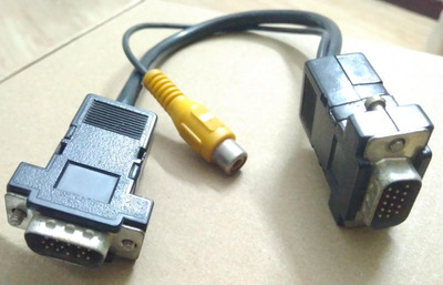

Reply 3 of 37, by RaVeNsClaw
Thank you for the reply! 😀
Yes, It's the card from ebay. The seller accepted my price proposal.
The card also came with a Y-cable with 2 plugs, "VGA" and "MPEG" and a VGA socket for the screen.

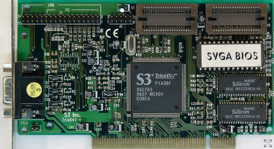

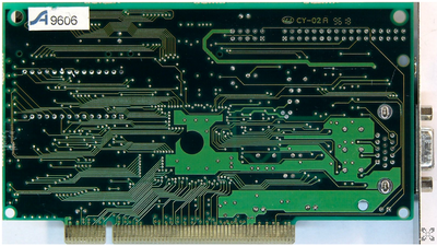

Reply 4 of 37, by deltashadow
Hi, here is some ideas:
1) What i a chip under a heatsink?
2) It looks like it is made in Taiwan (according to my info)
3) I know this video card - with the same CY-02
1.47 MiB
2071 views
and
1.34 MiB
2071 views
4) So maybe this "A" logo is a brand of this card. And the same to your board.
34.56 KiB
2071 views
So maybe somebody know what company is this "A"?
Because CY-02 sign is quite rare on boards.
Reply 5 of 37, by RaVeNsClaw
Hello deltashadow,
about your first question: Under the heatsink there is a Winbond W9920A-1.
But you are right, the logo on this card really is the very same as on mine! 😀
13.2 KiB
2022 views
The card you posted is also just listed as "CY-02A" on m.vgamuseum.info:
http://m.vgamuseum.info/index.php/cpu/item/359-s3-trio64v
I did a little upscale of the logo in question:
36.61 KiB
2022 views
EDIT:
There is also this card with the same logo and "Made in Taiwan"
https://www.eska-welt.de/ersatzteile/sonstige … ersion-a1/69803
It could also be, that this is just the logo of the PCB manufacturer.

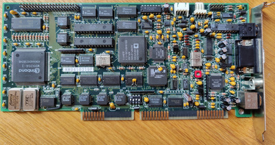

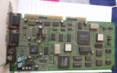

Reply 9 of 37, by RaVeNsClaw
Thank you all for the replies! 😀
I'm happy to see that you came to similar conclusions as me. I've counted 5 reworks on this card and the number of chips and tantalum caps is quite extreme.
So it's a rather early card from when the W9910 was not avalible yet.
Here is the front of the card without the heat sink:
719.05 KiB
1931 views
@rasz_pl:
I owned such a Ulead MPEG decoder 14+ years ago, but as you noted, it uses a different DSP.
That "Boser BS-250" card and the LifeView PCinema II both use the Winbond W9910 audio decoder, so sadly those won't work.
All of the drivers I've found require the W9910 and are basically the same driver with a different branding.

Reply 11 of 37, by GunKneeNeon
RaVeNsClaw wrote on 2023-04-30, 20:28:
I've searched around for the ADSP-2105 audio dsp chip. It's the same DSP as on the "Reelmagic" MPEG decoder cards.
In this russian forum in 2015 a card isa - "magic v1" fullmotion video accelerator - winbond w9920a-1, ad adsp-2105 was sold. So it had the same chip configuration:
https://www.phantom.sannata.org/viewtopic.php?t=18274
I own exactly the same card as you mentioned, magic v1 seems to be the product model, the manufacturer is still unknown. By the way, the card was bought from China mainland back in 1995 or so. Do you know how to find its driver? Maybe your card and mine could share the same driver.

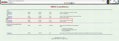

One more WINBOND MPEG ISA cards maker Vigour Taiwan
And their drivers in Archive.org
https://web.archive.org/web/20000304040919/ht … ice/serve-e.htm
Reply 15 of 37, by RaVeNsClaw
Babasha wrote on 2023-05-16, 20:33:
Thank you for the links! 😀
The drivers don't seem to be for a Winbond chip. The dll files copyright Dritek and the included MPEG player is Mediamatics.
Probably a special version, as Mediamatics MPEG Arcade is just a software decoder for Pentium systems:
https://archive.org/details/mpeg_arcade_player

Not entirely sure if relevant, but either of you care to give the attached files a closer look...
It doesn't work. When I hit play button in Media Player using this Device, it either doesn't respond or freeze. The big problem is that the card cannot be seen in Device Manager, Windows cannot find it. I have connected it to the VGA card using its own cable successfully. The graphic just shows through it like it's totally clear of the whole system. The other proof of its presence is that it renders my PCI NIC and/or Soundcard unusable.
