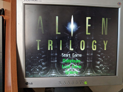

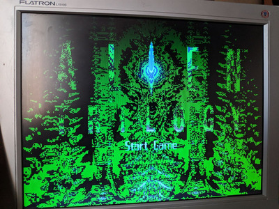

Reply 5 of 11, by wbc
Gmlb256 wrote on 2023-06-03, 14:30:
Mine is patched to version 2.0, TRILOGY.EXE being dated Dec 23 1996 16:06.
Tried booting DOS with just HIMEM.SYS and CD-ROM support, still freezes the computer with SDD 6.53 after the passing the "Detecting card" message. :(
installed the 2.0 patch, seems to work OK on my configuration :/ (UPD: tried on TNT2 M64, works as well)
If SDD is not loaded, vertical stripes are shown instead of copyright screen, and main menu colors are garbled:
271.01 KiB
1792 views
If I load the patched UNIVBE.EXE, then everything work as expected, with correct image:
150.09 KiB
1792 views
Does high-color version work on your configuration with cards that support 15bpp, for example S3 Trio/Savage?
--wbcbz7

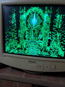

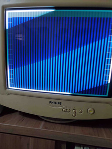

Reply 6 of 11, by Gmlb256
wbc wrote on 2023-06-03, 15:09:
Those vertical stripes and bad colors happen in my case too on nVidia video cards without SDD/UniVBE.
571.56 KiB
1767 views
Notice the overscan borders where the copyright screen should appear since I'm using a CRT monitor. Doesn't appear when it is displayed properly.
688.74 KiB
1767 views
Yes, it works without any problems on any video card that supports 15bpp out of the box.
