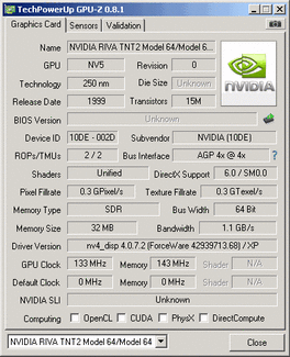

This is the GPU-Z info:
16.22 KiB
1205 views

I've attached a ROM file that came from GPU-Z, but the file size is strange so I don't trust it.
One benefit of being a very late produced card - this card maxed out the overclocking sliders in PowerStrip at 177MHz core, 190MHz RAM and there's still no artifacting. I'm not so surprised about the core but I am surprised the RAM can go that fast. It's only -7 rated.
Thank you very much for the info and the BIOS dump, shamino! It seems that attached BIOS dump file is OK - the last two bytes after the "field with FFs" are checksum for the BIOS.
So, from the picture from GPU-Z it is now clear that this strange TNT2 cards are actually M64 variants with 32MB RAM and 64bit bus with GPU frequency as of regular TNT2.

analog_programmer wrote on 2023-07-30, 18:35:
The SDRAM chips are some chinese "brand" of which I can't find any datasheets or info:
"VT3664164T-6"
I suppose they're 6ns, but who knows for sure?
Apparently those are made by "Kreton" who I've never heard of. There's a datasheet here:
http://www.datasheetwiki.com/PDF/616429/VT3664164T-pdf.html
It does give the max clock of the "-6" marked version as 166MHz.
