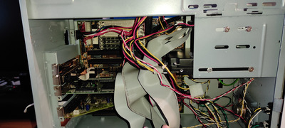

Several years ago I used Arctic Silver Thermal Epoxy, the stuff that's totally permanent, to attach a Socket-7 heatsink to the northbridge chip of an MSI 875P Neo.
I had big plans for this late P4 motherboard, but then I discovered I didn't like it, and aborted the project.
Anyway, yesterday I grabbed this board off the shelf. To my surprise the heatsink was loose in the bag.
53.93 KiB
1572 views
Huh. I guess it wasn't permanent after all.
I remember playing with the weight I put on it while the epoxy was curing, and I think the heatsink moved a little - but I thought it was solid. The 10 year test says otherwise.
It's an oversized heatsink and I guess it got pushed against.
Haven't tested the board but I think the chipset is undamaged. I just need to pick the epoxy off it now. Might use sandpaper if I have to.
It's a good thing it wasn't adhered strongly enough to rip the chip apart. Somebody had a picture of that happening recently.

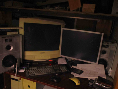

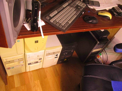

I have been putting my computer station back together finally after the desk upgrades, there's still much work left to do but if I really want I can play around with a 286, 386, 486, NexGen, Pentium and a P2 ~
350.39 KiB
1543 views
534.84 KiB
1543 views
I had to make a number of exactly in length LAN cables, turned out the ones I already got were all too short. In the end it was for the better, less cable clutter this way. Sound is another challenge that is to be overcome eventually, also involving custom cables and a homemade mixer with ground loop cancellation features ~
There's still way to go until hardware stuff gets done again but that is slowly shaping up too. Storage is still a major hurdle and lot of stuff still has to stay in boxes and only come out very temporarily...

Are they all hooked up to a KVM switch? Will you use a mixer for audio?
Bonus Question: Where do you put your feet 🤣

What, you don't use the smaller cases as footrests..?

All goes to a KVM, two even since there's a test computer too that is being set up behind the monitors. It is a PIII mobo where random stuff will be easy to test ~
Mixer is going to be self built out of a dead EQ with 20 sliders in front, for 10x stereo channels without swapping out the sliders for stereo ones.
Feet go under my ass, as they always have, and as mentioned the computers can support them too 🤣

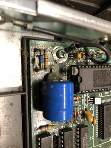

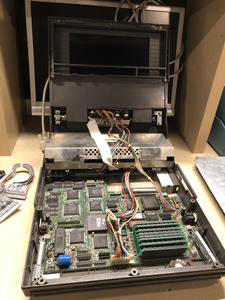

Today i tried to bring back this Highscreen Laptop 8100 back to life.
After i removed the leaking battery and took care of the damage i could try to start it.
The first thing it did was smoking... because a tantalum cap exploded with nice purple smoke...
The screen seems to be damaged, and the memory of the graphics card is broken.
It tries to work and even counts all 8MB of SIPP memory fine, but not very well with corrupted graphics.
Even if i can replace the video memory, the broken screen remains. And its just a slow 386...
The case is not very nice too. It was only held together with 5 Screws and the lid of the monitor is a different colour. The eject button of the floppy is missing etc...

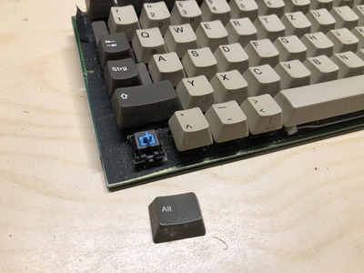

The best thing is the super awesome mechanical keyboard wich still feels brilliant.
Im thinking about repairing the graphics card and sell off the internals. Then i want to use the really huge case to build a "modernish" pc inside of it and replace the monitor with something not broken and in colour.
What do you think?
BTW: I dumped the BIOS (2 chips) and VGA BIOS (1 chip). If somebody is interested in these files, please let me know.

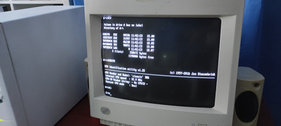

Yesterday I've done some cleaning / tests on my retro rigs.
Found out that my 386SX build didn't show any video output: I've solved by moving the video card to another ISA slot; maybe the previous one went faulty, which by the way isn't too much of a problem as I have no plan to install additional cards.

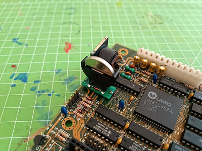

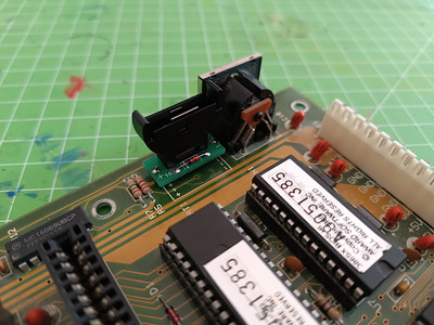

I'm adding a Not-A-Varta to my boards that a) have no BAT_EXT header b) are currently in a case. Fun times!
Question: Despite the diode I am reading a 0.02V charging voltage when powered on, I don't think that would cause issues for a CR2032, no?

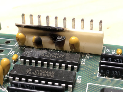

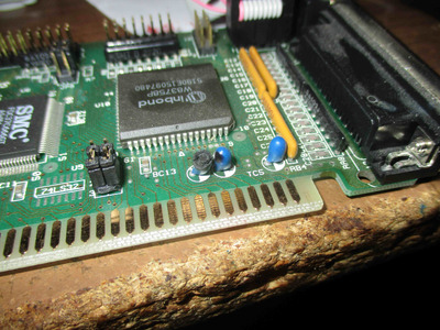

Speaking of explosions, I had that happen too to the 486 :
835.01 KiB
1886 views
joys of tantalum
I replaced all these little blue drops with something else, and hopefully the ones on the motherboard itself will not start going out like this anytime soon 🤣
The PSU immediately went into protection so that probably saved me from having a whole lot more fallout to deal with...
