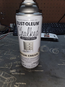

Out of everything "off the shelf" the best spray paint that I've found so far is a specialty "chalked" color from Rustoleum.
(Attached here)
But as always... Be careful and TEST. Mileage may vary.....

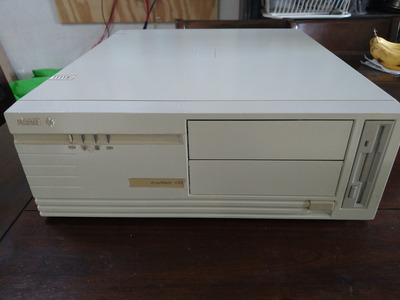

I've painted one of my cases in white. Mostly due to big scratches, bumps and rust strains.
It can give good results, but needs patience. Several layers of spray paint. Proper drying between layers. Masking the feature you don't want to be painted. Honestly I'm not good at spray painting but it was the last resort for this computer case. As period correct cases are hard to find, i didn't wanted to send it to trash.
The picture kind of exaggerate the paint defects and it looks better in daylight.
The power button is not the original one. This is why it looks weird.
I consider this as a moderately bad result and you should be able to have better results

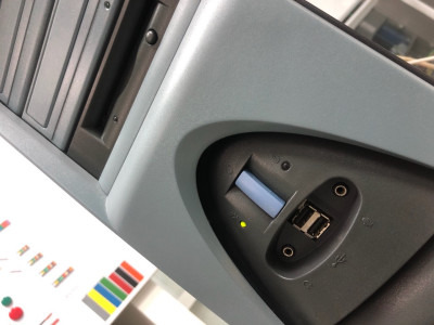

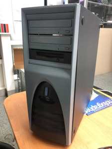

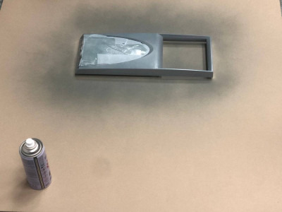

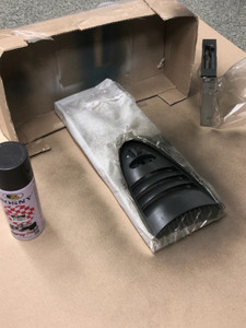

My painting experience 😀
