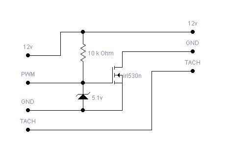

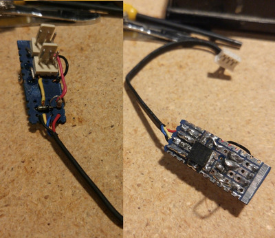

Woohoo, soldered up my 4 pin PWM to 3 pin fan convertor board... looks a bit grim though... my favorite soldering iron of 15+ years turned up dead earlier this year, so I'm struggling to get used to alternatives. It doesn't help they're all about 1" longer from the handle, so all my wobbles are magnified that much more. The one I was using, I'd been used to having a small bead on the tip, helped start the heat transfer, and would pull off the same bead when you took it off. This one is a narrow conical, and although the tip wets it doesn't hold a bead and pulls off without, leading to much blobbier joints thus far. No pic though at the moment, my phone died. Anyway, should have picked a much easier project to relearn soldering with a "new" iron, I made this one on as small a piece of board as possible.
You know what though, this iron should be much easier for surface mount, since it won't drag the speck of dust part away with it. Though I did have a turn of the wrist pinch off maneuver with the other one.
Got too late to test it, besides wanna check it with fresh eyes tomorrow. Figure I'll try it with 12V, should go full blast, then apply 5V to PWM input and that should cut it off (Pulse is inverse so applying 100% mark then 100% space effectively) .... though wait a sec it's tied high... apply ground to it first to get full blast I guess.
Reply 804 of 1049, by BitWrangler

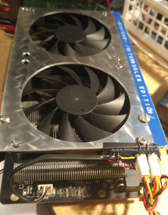

Hokay, bench tested it. Fans go brrrrrrrrr.
Installed on card... waiting for lightning to clear out of the area before I fire up desktops though. Power blinks have killed stuff on me before, and even the more benign brownout is not something I want to deal with in the middle of trying to test something.
Don't really expect to be able to tell anything much from these pics, the circuit is the one previously linked, first post top of page, https://www.techpowerup.com/forums/threads/so … pin-fan.115752/ hokay though I'll snarf it and upload it, in case it disappears in time...
    260.47 KiB
    1917 views
    Front and back of board, doesn't show very well but there's a paperclip soldered in to mount it by.

    PCB mounted to GTX1060BWE

    Design from Lazzer408 at TPU forum

Yay it works, but boo, it doesn't work. Turn on PC, fans on card come on, blow, begins loading windows, driver loads just before login screen, fans turn off... but that's fine, it's at like 18W power use on desktop... they'll turn on if I load it... and load it some more... and load it... crap, GPU-Z shows fan power demanded but it's not happening. Theoretically, top temperature for this thing is 83C... I am chickening out at 80, still no fan.... oddly, it seems to give the odd blurp at random times. RPM is showing wrong also keeps flashing up to 750,000, not sure if it's picking up EMI off the SATA cable or something. Have loaded Afterburner and put the fan slider up to 100... nothing.
BUT ... is it me or them? Lots of chatter about Asus 1060 cards being weird with the fans, and some special driver combo and moon/planet alignment required to get it working, *sigh* and since this is a used card, unsure whether BIOS fan profiles have been messed with.
Then also ... do I want to fix it on this test system? .. it's the AMD Athlon II X2 again running windows 7... I am putting this card in an M83 i7 4770 running windows 10, ultimately... do I assume this is normal stupid shit that is not worth the time to mess around with on this system and build out the M83 and deal with the problems there.
The known 1060 fan issues have been called system specific, it might not even do it in the other box. Or it might be a simple fix on this one and 3 years hard labor fix on the other. So I dunno, card can turn fan on, seen at boot, card can turn fan off, seen at login, in between, is that software snafu or hardware fubar ???
edit: just started wondering, did later series of cards start using 3.3V logic for their PWM signal??? I can't find any references or real datasheets for known fan models. Though since I have 4 pin fans known to be good for 10x0 series and later, I will try one on the header alone and see what happens. Also might just try the fans as is with the pwm header pin slid out, so I can assess max cooling potential.
editII: Had it on a ubuntu 22.x desktop the other day and the fans are turning there, not full blast, I wanna say about 40%, didn't have a doohickey lined up to check... (installs are 4 gigabytes of nothing these days, they used to be packed with utils on a CD install)

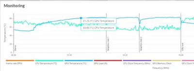

So for my 1060 fan control problem I've just been "letting it marinate" meaning not doing anything rash and seeing if understanding or amazing idea pops into my head about it. Meanwhile I come across things like this for the Asus Dual 1060s (Which this is one of) where users say this is normal behavior... (See image)
It is running a 3Dmark in that, not sure if 11 or Vantage, anyway, I know that while those test everything they don't actually go all the way for maxing power consumption/heat output, ~80% ish. I also know heatpipes "get going" above a certain temperature where the fluid is boiling and the sonic speed transfer fires up, so not sure if that's part of it. But dang, seems like a bit of a high temp to be playing around at... well at least when you're not sure if your fans are going to cut in and how quick they'll drop the temp.

    Random user temp graph, Asus Dual 1060

Rerun with GPU temp on and GPU load on to see more detail. There is reasons behind these.
PS: heat pipes does not need so much temp to go live. Heat pipe keep working even 10C difference from ambient temp. In fact, Switch worked off 5c difference too.
What makes cooling "seemingly" work better is temp difference, more easier to radiate off as heatsink itself gets more hotter not the heatpipe. In other words fan speed is set too low for given temps or too small.

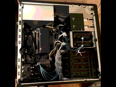

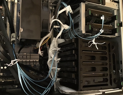

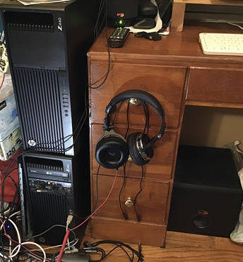

Finished setting up my NEW Daily Drivers and Home Theater Media Server.
I am using HP z440 Workstations loaded with Win-10-Pro ( $120 )
I have installed 64gb DDR4 ECC REG RAM ( $50 )
Nvidia Geforce Gt730 or 3060ti
Xeon 1660v4 ( 8-cores, 16-threads ) ( $50 )
Sound Cards - Creative X3 and Audigy 2ZS ( Motherboard has a ONE PCI Slot for sound card )
Blu-ray drives
LSI HBA SAS Controller with cables ( $70 )
And 8 large capacity hard drives in Media Server Build and 6 large capacity hard drives in Daily driver computer.
2tb Intel 670p Nvme SSD Boot drive ( $60 )
And I still have 6 Sata connections left on the Motherboards
And I can add More Nvme drives via a Quad PCIe Nvme Adapter.
So I have tons of room for more expansion.
This is most customizable and expandable HP Z series computer.
All you have to do is add an internal drive cage and LSI HBA SAS controller which I purchased on eBay for cheap.
These computers should lasts me 3 more years I hope.
These are the best deals on eBay right now as they are selling for about $100
They run and perform really good with Win-10-Pro
CPU Idles at 0-3%
Memory usage is 6gb with 58gb Available.
Each one cost me about $350 in parts not including hard drives and video cards.
NAS Parts Breakdown Cost:
HP z440 computer ( $120 ) eBay
Xeon 1660v4 ( $50 ) eBay
Internal hard drive cage ( $25 ) eBay
64gb 2133p ECC Memory ( $50 ) eBay
LSI 9300-8i HBA SAS Adapter with Sata Cables ( $70 ) eBay
Nvidia GT730 Video card. ( $50 ) ebay
Main Boot Nvme gen 3 SSD with PCIe adapter ( Intel 670p , 2tb ( $80 )
( NAS Grade Hard drives costs extra ) ( 8 x 20tb = 160 Terra bytes )
