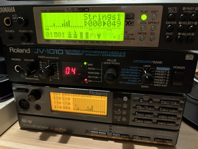

Some midis recorded by JV1010:
Final Fantasy 5 :
https://youtu.be/VAHKv86RLfc
LUNAR Silver Star Story:
https://youtu.be/uE9biRlthSM
Chrono Trigger:
https://youtu.be/TX3ooEBl2LY
https://youtu.be/JqV5JnXZzwQ
    1.48 MiB
    1497 views
