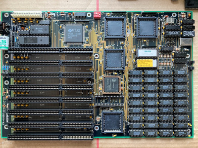

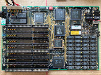

This 286 mainboard was repaired a while ago (VARTA damage) and ever since ran with 1MB RAM (36 DIL 256Kb chips) with parity enabled without any issues.

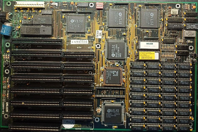

Here you can see it´s original condition:
277.83 KiB
718 views
Recently I removed the 256Kb chips to upgrade to 2MB with 18 1Mb chips in BANK0 and everything continued working fine.
Trouble started when I upgraded to 4MB RAM by adding another 18 1Mb chips in BANK1:

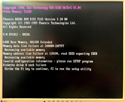

With parity disabled (jumper J11 in position 1-2) everything´s still fine but as soon as parity is turned on I get something like this:
178.91 KiB
1113 views
When the system is set to 8MHz instead of 12 MHz, memory count will finish, but as soon as I load any software under DOS, parity errors will be detected and the system halts.
In the meantime I have tried several sets of DIL RAM chips (Siemens, Toshiba and Motorola) in various positions and combinations, at one point the first error message disappered, but the "120104" error persists. (sometimes it´s 120102 or 120100) The DIL chips are running flawlessly on other 286 / 386 mainboards.

There´s still no progress narrowing down the cause of these parity errors.
The "Memory address line failure at" error randomly attains the values 120102, 120104 or 120106. In any case "EDED" is both expected and read.
Replacing whole banks of memory or replacing the DIL chips one by one has no effect.
Contrary to what I wrote in the opening post there´s also an error with just "BANK0" populated.
The only options to increase the siutuation is turning off parity or reducing CPU frequency permanently to 8MHz or using 16-pin 256Kb chips only.

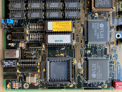

Cooling the chips with coolant spray before startup revealed that memory check and running software caused no errors when the system controller chip "VL82C101B-QC" was (heavily) cooled before starting the system.
I removed it and put a PLCC84 socket in it´s place to continue the tests as soon as I can get my hand on another working 82C101.
1.13 MiB
993 views
I also need to find a spare PAL chip, because the mainboard came with a defective Acer "C13-10-1BS 8946". (I wonder if the last 4 digits are just a date code?)

This is really odd.
Memory data line failure at 2A0000-2AFFFF
Memory address line failure at 120103, read EDED expected EDED
Did I understand correctly that the BIOS during the memory test read what was expected, but perceived it as an error?
Because EDED == EDED, isn't?
Reply 6 of 22, by majestyk
It´s like throwing a dice:
Sometimes it reports an error when the expected value differs from the read value and sometimes it complains when both values are identical.
The VL82C101 contains "two 16L8 PALs for memeory decoding" so I hope that things are being messed up there.

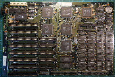

p.s. I have also a quite similar 286 MB based on VLSI. And now I'm torn by curiosity and want to try to upgrade it to 4 MB, maybe I will run into similar problems.

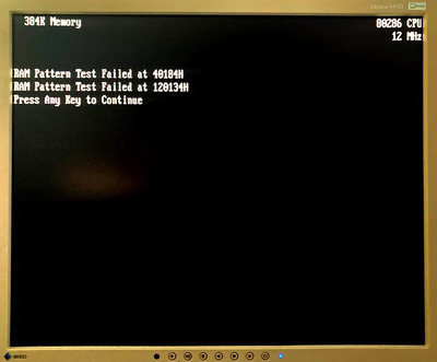

At the moment I´m testing with a MR.BIOS and I get two errors when it tests memory:
38.97 KiB
869 views
The hex-values are not always the same. The 3 digits after 40 in the first line and after 120 in the second line vary randomly. I assume "H" denotes Hex values here.
Sometimes there´s a third message: "Banks Decode to Same Location: 2E0000H and 2A0000A"
Since it depends on frequency I wonder if this could be some termination issue?

Reply 18 of 22, by majestyk
I also have this Toptek VLSI mainboard (it was the one I borrowed the chips from). I tested it with both SIPP sticks and DIL chips (4MB) and it worked perfectly.
I guess you have checked all the solderings of the PLCC84 chips carefully / resoldered them all?
My FTK VLSI board wouldn´t start occasionally and I had resoldered all the pins except one angle of a chip that is only 1 cm apart from an ISA slot, and only after I resoldered these remaining 21 pins the issue was fixed.

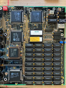

On my Unitron I cleaned up everything and reseated the original chips:
