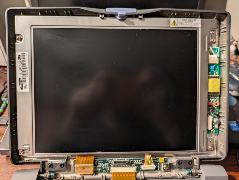

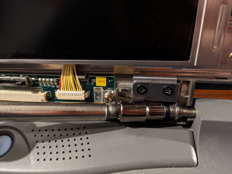

I will share my experience in servicing hinges on the Samsung Sens 800 and similar models.
By the way, I try to store all my laptops in an open, working position, so that if the hinges jam, the laptop can continue to be used. It is known that the highest load on the plastic surrounding the hinges occurs when the lid is opened.
The Samsung manufacturer thought about the users back then and made the hinges as convenient as possible for adjustment and lubrication. Firstly, you do not need to open the base of the laptop to do this; just remove the front panel of the screen (laptop cover). There are no screws, everything is on plastic latches, I recommend starting prying from the bottom part, usually hidden from view, in addition, the bottom part of the panel is not recessed into the cover body. The plastic of this laptop is quite durable; after 15 minutes of disassembling and reassembling, I didn’t seem to be able to break anything, the main thing is to do everything slowly and in a good mood. After opening we see this:
If you don’t want to lubricate the hinges, then having the appropriate tool you can simply loosen or tighten them:
But by unscrewing the 4 screws securing the cover, you can simply pull the hinges and pull them out of the connector, yes, imagine quick-release hinges here!
Don't forget to disconnect the central cable if you don't want to damage it.
After lubricating the hinges with WD-40, we put the cover and cable in place, insert and screw the hinges, and adjust according to how you feel.
I recommend assembling the front panel in reverse order from top to bottom, but be sure to make sure that the brightness slider matches, otherwise you will have to open it again.
