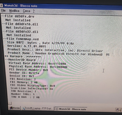

Voodoo 1 with "TMU PowerOn Sense: 0xdead", "Board 0: Bogus number of TMUs (57005)!" & "ERROR: b_sum=0x060 r_sum=0x030"
Visit my AmiBay items for sale (updated: 2025-02-16). I also take requests 😉
Reply 6 of 37, by iraito
Looks pretty weird, 2mb? Also the software part should be there.

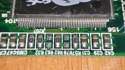

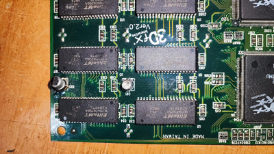

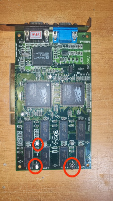

I took a glance at the card, it seems like it was missing 3 caps near the ram, I took equivalent ones with a higher voltage and put them in place.
Still the same issue, still only 2 megs perceived.

Reply 13 of 37, by iraito
sdz wrote on 2023-12-15, 20:32:
Perhaps missing/cracked resistors. Some of them are quite important.
I checked, resistors seems to be all there and in good conditions too, only caps were missing but i replaced them.

Reply 14 of 37, by iraito

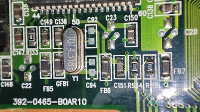

More pictures
MIDI Devices: RA-50 (modded to MT-32) SC-55

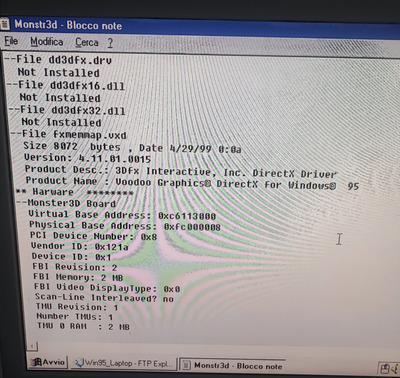

2MB is normal - that's 2MB for the framebuffer and 2MB for textures on the 4MB Voodoo 1 cards.

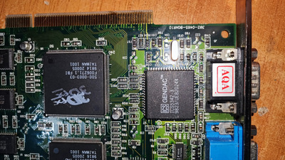

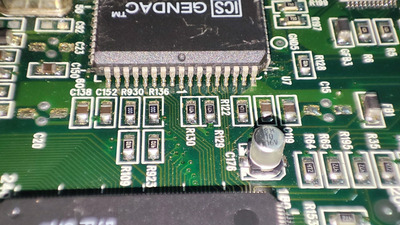

Your mojo result is 100% looking good so the communication between the PCI bus, TMU and FBI chips are each working. The RAMDAC is responding correctly since mojo will throw serious errors if it isn't - but what mojo can't tell is whether the RAMDAC's analogue side is properly powered and hooked up.
You stated in the 1st post that you're using the loop cable into your 2D card so the VGA port and VGA pass-through functionality are functioning and it's just 3d mode that's giving a black screen.

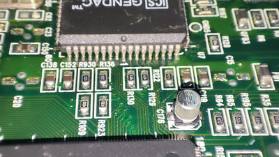

Please check the pins on the RAMDAC for anything that looks suspect: https://retronn.de/ftp/docs/pc_hardware/DACs/ICS5342.pdf
Pins 43 & 44 are the power inputs for the analogue side of the RAMDAC. You should also probably check the inductors (FBx & GFBx) dotted around the RAMDAC area to make sure none of them are cracked and that each one has 0-ohms resistance, that's pretty common for those to get broken or go missing especially since it's been stored in such a way that capacitors were broken off.

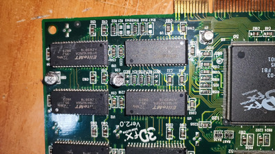

Reply 17 of 37, by iraito

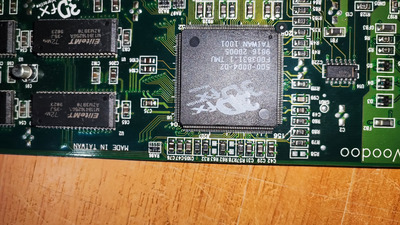

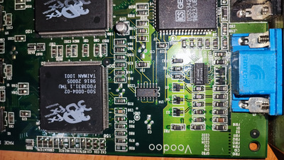

I'm the meantime here's more pictures.
