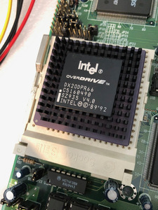

I have a couple of overdrive CPUs that get a little too hot for my liking. For a standard 486 you can simply buy a heatsink and fan that clips onto the CPU (https://www.ebay.com.au/itm/185840766419), however the overdrive already has a heatsink so the heatsink clip won’t work. Is there a way to attach some sort of fan to it?

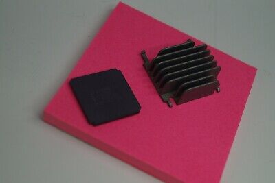

I've often thought about buying heat sinks for my 2 MB EMS board from the mid-80s (AST RAMPage 286).
Btw, the early ceramic 286 proccesors saw a need for a heat sink, too.
The higher clocked LCC models (8 to 10 MHz) got quite hot, at times.
9.08 KiB
1402 views
Source: (link)

Reply 14 of 30, by zuldan
So I measured the temp of my DX2-66 Overdrive and it sits at 57c. I haven’t measured my DX4-100 Overdrive so I’m guessing that will be just over 60c. I guess the temps seem to be ok but I think I’ll get a fan for the case. Would like these girls to last as long as possible.

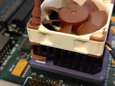

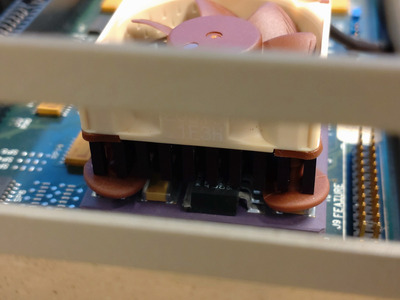

Bit off topic since it's a DX4 overdrive. I pushed two silicon 'Vibration Compensators' in the heatsink, thanks to spacing for the voltage regulator.

Reply 18 of 30, by Trashbytes
PD2JK wrote on 2023-12-23, 08:49:
Not saying its a bad thing but I would be worried about the silicon insulating the regulator and causing it to overheat, I guess it depends on case airflow and how thick the silicon pads are.. IIRC they could take a bit of heat but its a voltage regulator so I would be cautions for anyone else wanting to try this.
Reply 19 of 30, by PD2JK
Trashbytes wrote on 2023-12-23, 09:04:
No worries, it can breathe. 😀
Even gets some airflow from the fan.
