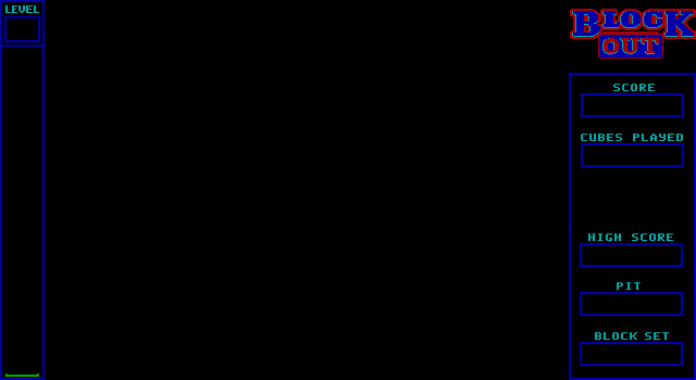

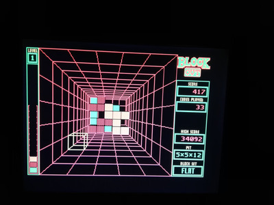

Reply 293 of 309, by Grzyb
dr.zeissler wrote on 2024-01-03, 16:36:
we should really make a new thread with native hercules games that use the full resolution and do not use internal cga emulation.
You can create such a thread yourself!

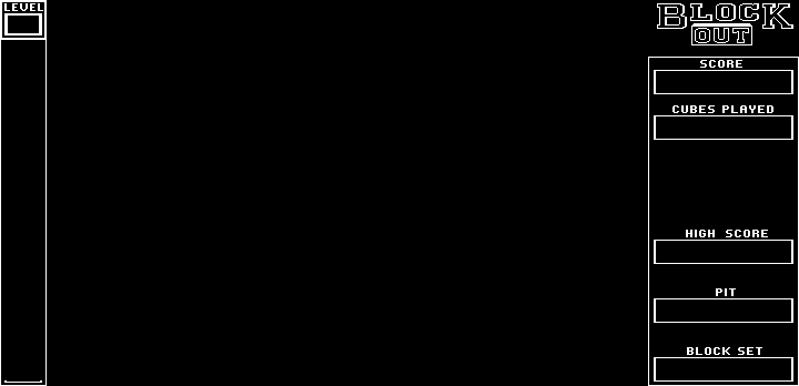

Meanwhile, I'm going to elaborate on the game that's probably the most popular in that category:
Blockout
It got created in 1989 in Poland, which was already a miracle!
It was still the Cold War era, the entire Eastern Bloc was isolated from the West, and computers were very hard to afford.
For games, there were 8-bit machines: ZX Spectrum, Atari, Commodore 64 - but nobody was thinking about a PC for that purpose.
But it somehow did happen: a group of programmers in Poland got in touch with a publisher in the USA, and released several games, for various platforms - including the IBM PC.
And among them, there was Blockout - not only providing great gameplay, but also very interesting from technical point of view.
Here, I'm about to focus on one aspect: exemplary handling of various video modes.

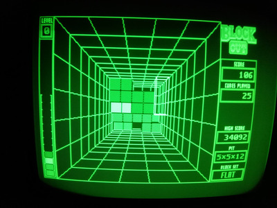

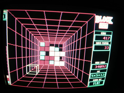

As we all know, vast majority of games is best played on the latest hardware available when a given game was released.
Games from the CGA era were made to use CGA to the max, and often look very good indeed.
In the EGA/VGA era, there was still plenty of titles also supporting CGA, but with minimum effort - such games typically look awful in the 4-color mode.
And in the Hercules era... no, there wasn't Hercules era in gaming, so don't expect anything good here 😜
But there's this exception...
2.72 KiB
999 views

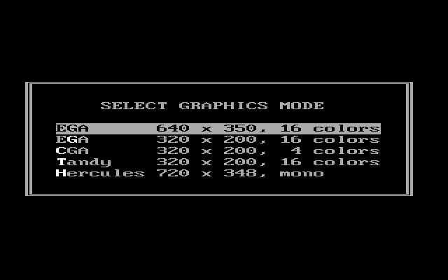

First, note the two EGA options - the most basic configuration (64 KB of video RAM and/or CGA monitor) is also supported to the max!
Various cards are supported at various resolutions, and there are SEPARATE graphics data sets for each of them:
2.07 KiB
999 views
1.08 KiB
999 views
1.08 KiB
999 views

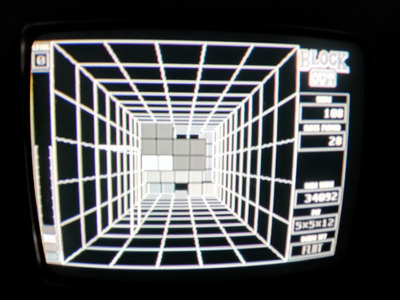

There are also three carefully-designed color palettes:
- solid colors for 16-color modes
- simple 4-color patterns for the 4-color mode
- intricate monochrome patterns for the monochrome mode - and note the light-dark-light-dark... alternation!

And finally, Blockout makes use of one hardly ever used feature of Hercules: DOUBLE BUFFERING.
Programming animated graphics in the native Hercules mode must be more difficult than in CGA emulation:
720 x 348 x 1bpp = 31320 Bytes
320 x 200 x 2bpp = 16000 Bytes
Availability of two video pages, however, may be helpful here.

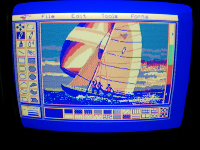

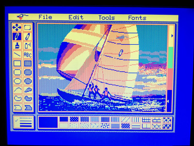

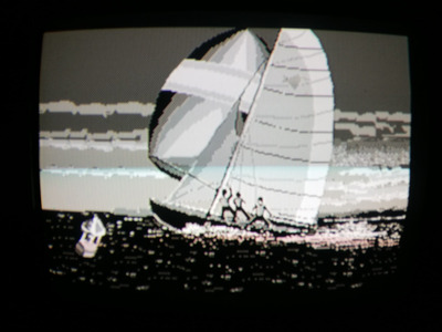

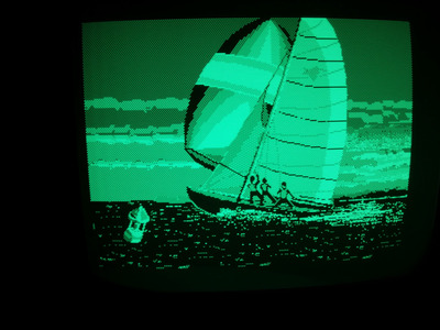

Thank you for these kind words! ^^
The XT era is new to me, too and I'm often worried I'm a bit too chatty. 😅 My sister says so, too.
I've attached some pictures for you and the others, it's about PC Paint (CGA). 🙂
The monochrome pictures were taken with a real XT PC with a true CGA card (ancient Hitachi CRTC, even, not just Motorola).
Yes, the FS4 video is a real classic!
I've seen it back when it was "new", though it never gets old!
"Broken Wings" fits nicely to it, too!
In principle, someone could recreate the video using a copy of FS4. I'm just not sure which demo modes were being used (FS has script support I think).
PS: I've taken some more pictures, for you and Grzyb. It's about Blockout on CGA.
Depending on the CRT monitor, the dithering really works. 😄
@OldCat I hope it's okay that I've attached two colour pictures below.
I've just thought it would be good as a little comparison. Blockout was beeing shown earlier in this thread, in Hercules monochrome. So I thought that's okay.
I didn't mean to go off topic, whatsoever. I have a soft spot for monochrome graphics, too, after all. 🙂👍
Edit: I've taken two more pictures in monochrome..
