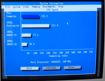

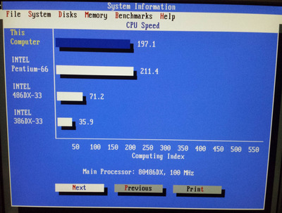

So I finally managed to do some benchmarking on my DX4-100.
LGR got a score of 132.3 (https://youtu.be/t4HMHOTb8hc?t=490). I believe Phil got the same score on his DX400-100.
The attachment Untitled.png is no longer available

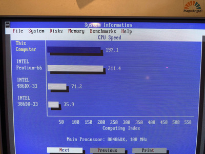

However, on my DX4-100. I'm getting 197.1
The attachment IMG_4107.JPG is no longer available
Is there some bug that can distort these numbers? Or something I can turn off in the BIOS to get the real benchmark speed?

Reply 9 of 22, by watson
Well, here is my result. Standard Intel DX4-100 (S-Spec SK051, write-through) on Soyo SY-4SAW2. It is identical to yours.
Therefore, I think we can conlude the "correct" score for this CPU is exactly 197.1.

Reply 10 of 22, by konc
Norton's SI will react to things like memory timing, so it's not like it should show exactly 197.1, but something close to that if settings are optimized. I get 197.0!

LGR was using a ACER VL15g motherboard with a AMI BIOS. That BIOS is holding the board and processor back.
TheMobRules wrote on 2023-07-30, 01:25:
I noticed that the AMI BIOS for SiS471 boards suck ass (both on this board and MSI MS-4132G for example). For some reason they ignore the fastest timings for DRAM and cache set in the BIOS, and other settings are messed up (local bus T2/T3 and SYNC/TRANSPARENT are inverted). I wonder why AMI fucked up these in such a way and never bothered to fix them.

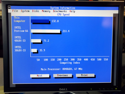

Reply 15 of 22, by Shponglefan

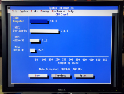

I just did some benchmarks comparing a 486 DX2-66 versus the 486 DX4-100 overdrive in the same system. I get identical Norton SI CPU scores of 132 with both processors, but the DX4-100 is faster in every other benchmark.
System Specs
Motherboard: ECS UM486V (UMC UM82C480 chipset)
BIOS: MR BIOS v1.65 (default settings)
L2 Cache: 256KB
RAM: 16 MB
Video Card: Cirrus Logic GD5428 (1 MB)

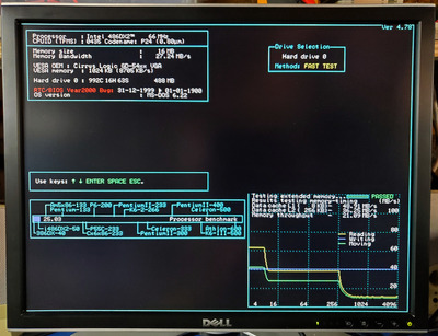

486 DX2-66 Benchmarks
The attachment 486DX2-66 Norton SI CPU.jpg is no longer available
The attachment 486DX2-66 Speedsys.jpg is no longer available
Norton SI CPU: 132.0
Speedsys processor score: 25.03
3D Bench: 43.4
PC Player 320x200: 9.4
Doom (high detail): 25.3 (2957 realticks)
Quake 320x200: 6.9

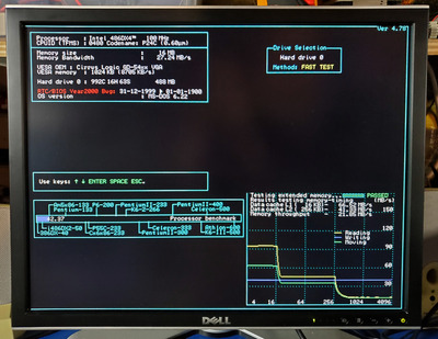

486 DX4-100 Benchmarks
The attachment 486DX4-100 OD Norton SI CPU.jpg is no longer available
The attachment 486DX4-100 OD Speedsys.jpg is no longer available
Speedsys processor score: 39.40
3D Bench: 55.5
PC Player 320x200: 13.6
Doom (high detail): 31.4 (2377 realticks)
Quake 320x200: 9.2
Despite Norton's SI CPU score being the same in both cases, all other benchmarks show higher performance for the DX4-100 overdrive compared to the DX2-66. Performance differences range from 24% faster (Doom) up to 57% faster (Speedsys) for the DX4-100 overdrive.

Reply 16 of 22, by Shponglefan

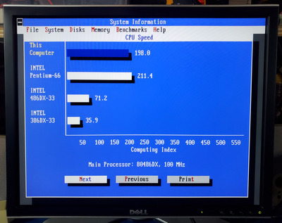

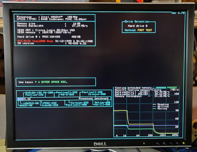

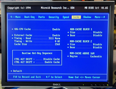

I just did some further testing and experimenting with BIOS settings and the DX4-100 OD processor.
It seems that the Norton SI CPU score is specifically sensitive to the cache write timing setting. Changing it from 1 WS (default) to 0 WS results in Norton SI reporting a CPU benchmark of 198 instead of 132.
The attachment MR BIOS cache settings.jpg is no longer available
I did further benchmarks with results as follows:
The attachment 486DX4-100 OD Norton SI CPU - 0WS write.jpg is no longer available
The attachment 486DX4-100 OD Speedsys - 0WS write.jpg is no longer available
Norton SI CPU: 198.0
Speedsys processor score: 42.37
3D Bench: 62.5
PC Player 320x200: 14.1
Doom (high detail): 33.1 (2258 realticks)
Quake 320x200: 9.5
Performance difference ranged from 3.3% faster (Quake) to 12.6% faster (3D Bench) based on this one BIOS setting.

Reply 17 of 22, by Shponglefan
zuldan wrote on 2024-01-04, 08:00:
Just based on my own testing, changing the cache write timing from 1 WS to 0 WS resulted in changing the Norton SI CPU benchmark from 132 to 198.
It also resulted in a general performance improvement, but not nearly as dramatic as that Norton SI benchmark would indicate. 😆
