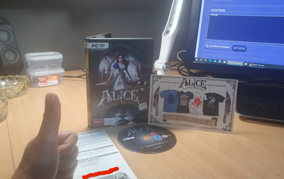

Im pulling out some old windows games and one is Alice Madness Returns, it installs fine from the original DVD but there is a copy protection that involves connecting to a server to receive an encrypted key, it then would unpack the files it copied to the HDD to complete the install the problem is the server to my knowledge isn't up anymore, there is an offline option if I edit an ini file that starts a window to go to an archive.org page by uploading the file the game window made and then I had to type my licence key and a capture code but it doesn't work, is there a way to play this DVD version at all anymore?

Aye capin trash n bytes, by me scurvy sea legs Isa swear me gotten booty is not fools gold but it was a steal for the low urchin of tree apples ($3.00) I be lookin here and thar and while scratchin this ol bum o mine I be thinking I better look down the crack of a plumber and hopes I dont a foul the mistress of the dead (not a stab at you vogons I swear I am typing this in the best pirate lingo I can muster) while being on board the wench because if someone shouts thar she blows I'll keel haul thee windows kargigga and have tee start me a new crew
