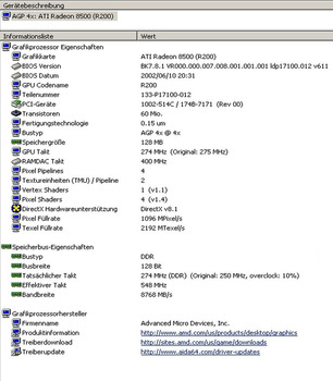

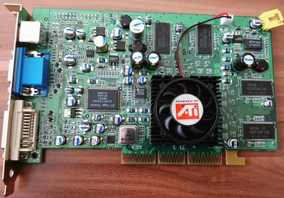

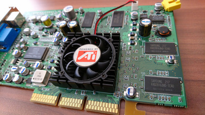

Reply 46 of 55, by NostalgicAslinger
Here is my Radeon 8500 128MB, default clocked with 275MHz Core and 250MHz Samsung TSOP 4ns memory. Really strange version (because the backside sticker says Radeon 8500 (not LE), but the 4ns Samsung DDR memory runs completely stable with 275Mhz, not higher tested.
Also HERE a older video in demonstration with this card and the Samsung memory clocked to 275MHz.

Reply 48 of 55, by stef80
Trashbytes wrote on 2024-01-10, 15:04:
Its weird because there isn't much difference between the 8500 and 8800 aside from the VBIOS and core/vram speeds .. makes me wonder what they changed in the bios that affects OpenGL.
It's probably some zero-ohm resistor in different position connected to GPU registers. Driver will always see it as FGL card regardless of VBIOS.
Grem Five wrote on 2024-01-12, 03:16:
I got mine a couple years ago on Ebay for I think $42 USD and the seller had the auction labelled "8500LE". The label on the bac […]
I got mine a couple years ago on Ebay for I think $42 USD and the seller had the auction labelled "8500LE". The label on the back says its and 8500 128 and so does the 275 clocks.
Nice card, probably late release with BGA memory.

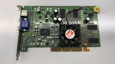

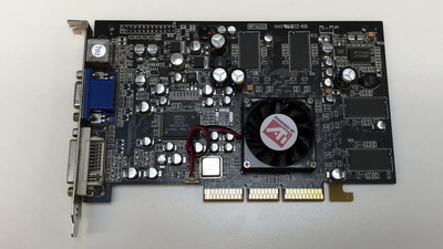

Reply 53 of 55, by appiah4
I have two R200 cards.
One is a Chess Radeon 8500 64MB 275/275:
508.08 KiB
381 views
The other is a Dell Radeon 9100 64MB 250/250:
647.17 KiB
381 views
To be honest there is no tangible performance difference between the two..

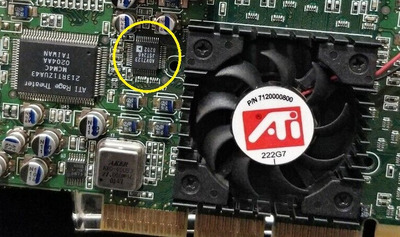

Reply 54 of 55, by Trashbytes
stef80 wrote on 2024-01-13, 11:28:
It's slightly different chip. with half as many TMUs.
Yup, got it mixed up with the 9100 ..which is the rebadged and down clocked 8500, ATI had too many 9000 series cards with similar specs. The 9100 does have a few PCB differences like the missing small chip (Ramdac?) that the 8500 has. Though not all 8500 cards seem to have this smaller chip, the 9100 also doesn't have the large silver crystal either.
- should clarify its not he large theater chip but the small square one that sits next to the GPU core.
123.92 KiB
355 views
8500
Circled chip

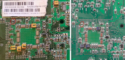

Reply 55 of 55, by stef80
I have encircled most obvious point, where you could do something. There are also other differences.
1.46 MiB
310 views
