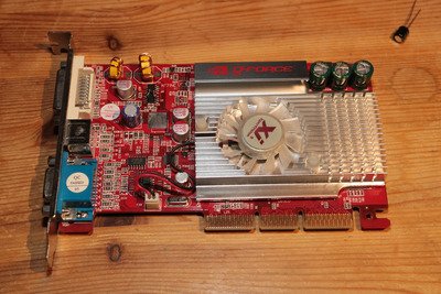

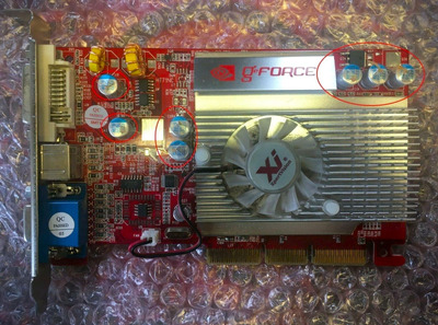

For entertainment value I purchased this non-functional FX5200 video card for £15, which is a bit pricey but it looked like fun to fix:
475.83 KiB
982 views
Now that I've actually used them some, I'm liking the Geforce FX series for old gaming and overclocking. I only ever saw Geforce 4 Ti4200 > Radeon 9700 > Geforce 6800GT back in the day and never used an FX card. The drivers have an auto detect function for overclocking and can pretty reliably find memory errors. The cheaper cards i.e. everything under the FX5800 series have basic VRM so volt mods are easily done with resistor modifications.
The FX5200 series is a mess though with so many cards having just 64-bit wide slow DDR memory and they were often built very cheap. This one's no exception but I could tell from the design and cooling that it had 128-bit wide slow DDR memory - which was correct, this card has 8 chips for the full 128-bit wide memory bus, with a paltry 5ns rating so they'll top out around 400MHz or maybe a little more.
Fixing the card requires all new capacitors, all the 1000uF caps are no longer functioning and have popped. There are so many schematics for these cards that have been leaked over the years, which I could refer to for cap values, but this one was relatively easy to figure out. In the top right there's what appears to be a linear regulator doing the memory voltage rail(s), that's a pretty simple looking setup so it gets some regulator electrolytics there.
Then on the left by the DVI port there's the GPU voltage rail with the usual buck regulator with high/low mosfet thing. Looking at similar cards made with better parts, it made sense to use polymer capacitors for the buck regulator and one of those purple caps for its power feed.
In this case the high/low mosfet is all in one package (9926B) and the F72820 controller is right next to it. I'm getting good at identifying where the resistor pairs are for setting voltages and the numbers on the resistors match on both my spreadsheet and actual DC voltage measurement. Adding a little 3.3k resistor between the feedback pin and ground pushes the vcore up from 1.52v to a slightly hotter 1.58v - the heatsink is big enough to handle that I think.
1.01 MiB
982 views
After the cap replacement the card worked first try and has no memory issues 😀 the fan is nice and quiet too. I had a go at overclocking it and it's beating my GF3 Ti200 at its best so it's a pretty good card:

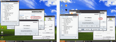

Noooo, you're letting the secret out, the 0-$20 cards that substitute the mostly very spendy DX8 cards. Let ppl keep going on about how much they suck 🤣

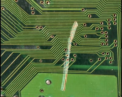

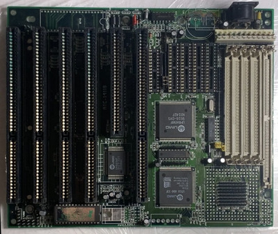

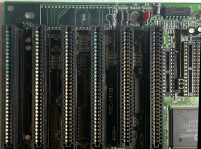

A little while ago I ordered an old 486 motherboard, with a soldered 486 chip from UMC, the conditions are more than fair, some repairs need to be done, I hope to succeed, I have a similar motherboard in my collection, always in need of repair, maybe one or the other sooner or later I can make it work, possibly, if you have suggestions and want to follow the repairs and tests on this and other MBs, you can always find them here on vogons.

Hmm..! I guess the very much higher 3d mark score has to do with the fact that the gf3 does not run the nature demo, but the FPS is clearly higher!

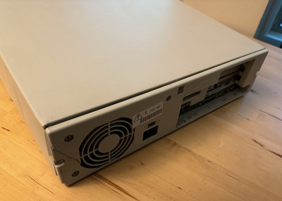

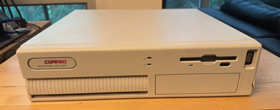

Picked up a Compaq Deskpro XE 450 for a decent price.
227.92 KiB
667 views
Some damage in shipping, but doesn't look too bad - a little bending and gluing back together should put it right.

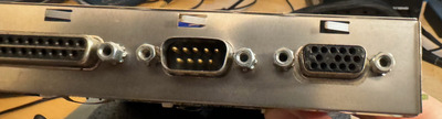

What's going on with the video connector? Compaq making people use proprietary monitors? Assuming it's VGA-compatible. It's got 3 full-size ISA slots, so a video card and sound card to replace the terrible onboard ones is probably the way to go anyway.
