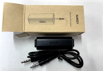

Reply 800 of 923, by Kahenraz
Out of curiosity, you can try a ground loop isolator to see if it makes a difference. This was the only way to quiet a particular ISA ESS AudioDrive I have which always had a lot of interference bleeding into the line out.
It sounds like audiophile voodoo, but it really does work, when it's actually solving the kind of problem it is indeed to.

Kahenraz wrote on 2024-02-14, 21:23:
Thank you for the suggestion. I wonder if this would work for my scenario - the noise increases when there is IDE (ex: loading Doom) or mouse activity.

Reply 805 of 923, by Kahenraz
I don't think it's possible to have noise through SPDIF that is originating from the sound card, because it's purely digital. Wouldn't the noise have to come from the speakers or some other analog component?
Reply 806 of 923, by airs
Kahenraz wrote on 2024-02-15, 18:40:
I'm not an audio engineer but I don't believe the path is fully digital - isn't there an ADC prior to SPDIF output? There can also be noise in a fully digital path due to jitter (and other variables?) - exemplified by the variance in SINAD measurements between audiophile DAC products.

Reply 810 of 923, by Shponglefan
The noise symptoms described do sound like ground loop interference. I've had this situation on a studio computer setup. Even over things like USB or Firewire ports, the noise would persist since all the noise needs is a ground connection. The actual audio equipment was irrelevant, as any audio interface connected would pick up the same noise.
One way to test if it is a ground loop issue is to run the system off a battery bank while not plugged into the socket. If you have an uninterruptable power supply, you could try running it on batteries only (again, unplugged). If the noise disappears, it's a ground loop problem.
You could try ground loop isolators as a possible solution. In my own situation, the only thing I found that worked was a USB isolator and putting that between my computer and my audio interface.
