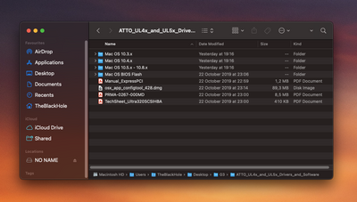

I just purchased this SCSI U320 card for this machine:
303.37 KiB
1071 views
Unfortunately it won't run under Mac OS 9.2 as the driver doesn't support it, so I'm going to have to upgrade to Mac OS 10.4.11 Tiger, as Tiger is the latest version of Mac OS which will run on the G3! 🙁

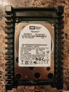

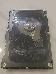

I don't want to destroy the Mac OS 9,2 install, so I plan to install a Pair of these Hitachi 15KRPM U320 SCSI drives. (The same type that are going into my Dual Pentium Pro build)

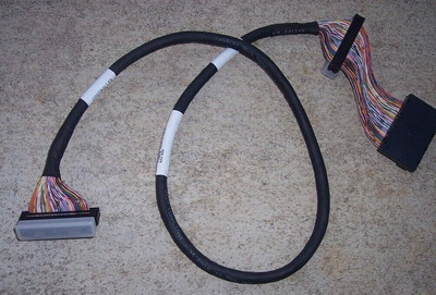

I intend using a pair of these SCSI cables to wire the drives up and keep everything neat:
197.92 KiB
1065 views
I will attempt to go with software RAID 0, but if that fails I'll simply install the OS on one of the drives and use the other to store ISO's
EIther way, this system's going to receive a significant performance upgrade as far as the system drive goes!

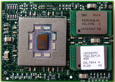

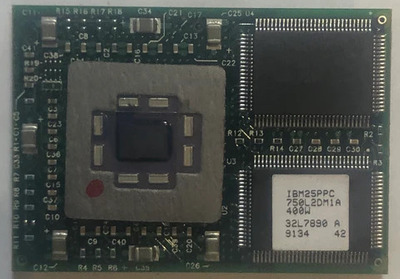

This Machine is fitted with the 450MHZ G3 CPU, the fastest that was officially released for this machine:
465.5 KiB
992 views
253.81 KiB
1035 views

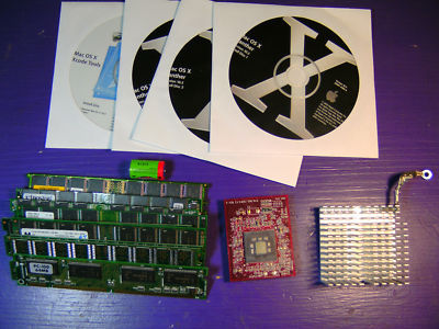

The G3 400MHz module looked like this:
49.11 KiB
1035 views
Notice the difference in the cache chips.

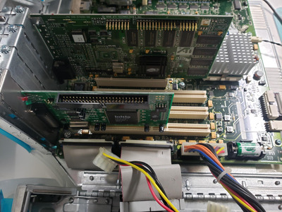

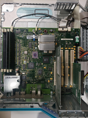

Reply 9 of 38, by Aui
Hi and thanks for sharing this build. I have a similar machine and your post entused me to maybe get it up and running again. However, I have close to no experience with these more recent Mac "PC's" so I hope you dont mind a few questions. At first the machine would not post at all, so I replaced the battery . Now I get an on screen question mark alternating with an imac logo so I guess I will need a new HDD ( currently non onboard). Since the on board connectors seem to be normal IDE, could I simply pair a Sata SSD with and SATA to ide adapter and be done? Or is SCSI a better solution? The machine got an on board SCSI adapter but I wonder how easy it is nowaydays to find a appropriate drive ( I have neither any machanical drives left)
Also, in terms of OS could you share some insights what are the pros and cons of using the period correct one (which one would that be ? Would it play the original Prince of Persia still?) or a more modern one?
Some images attached and thanks for any support already in advance.

Reply 10 of 38, by Irinikus
You appear to also have the 450MHz CPU, judging by the cache chips sticking out from underneath the heatsink!
You may just want to take a look at the label on this chip to confirm you have the second revision of the motherboard, as the first revision had issues with its IDE controller:
500.93 KiB
812 views
I'd personally go with a SCSI setup or a SONNET SATA expansion card.
However the SCSI card that you have installed won't cut it for a system drive!

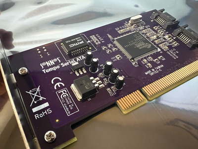

I just stuck one of these into my machine to control a secondary SATA drive: (a 750GB Seagate)
431.35 KiB
797 views
The machine sees this card as a SCSI controller!!!

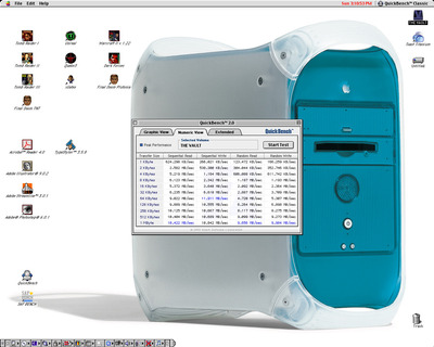

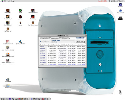

Here are the speed test results from this secondary drive:
274.03 KiB
807 views
Here are the results from the system disk: (SCSI Ultra 2 Wide on a crappy controller)
273.29 KiB
807 views
You can see that this drive is significantly slower! (I've transferred all my games to the faster secondary drive!)
This is the current drive and card configuration:
259.99 KiB
787 views
At this point, I'm not sure if I want to keep Mac OS 9.2 with a fast secondary drive setup.

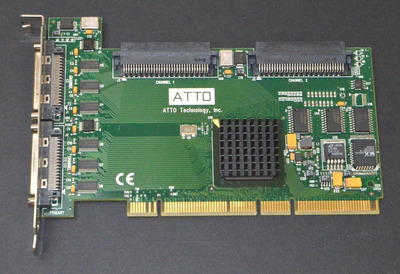

The ATTO card that I ordered is actually from the G5 era, so it would maybe be a very interesting upgrade for one of my G4's running Mac OS X (As besides this machine, I still have 3 G4's to upgrade and make interesting in their own ways!)

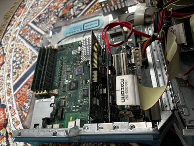

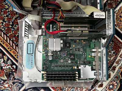

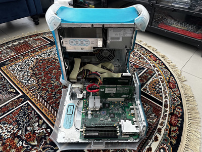

This is what the inside of this machine looks like at present:
1.68 MiB
710 views
1.39 MiB
710 views
1.72 MiB
710 views
And yes, that FUGLY Foxconn SCSI cable's got to GO!!!
It will look and perform much better once the Raion 9200LE is installed!!!
