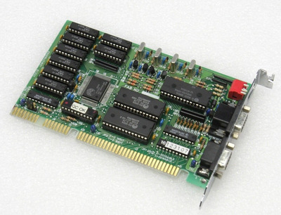

Reply 18 of 30, by Kahenraz
I picked up an Oak Technologies OTI-037C for cheap on eBay. It has a dual VGA/Mono output. I think that it might be possible to disable the VGA portion through the dip switches, but I'll need to get some kind of retro box to convert the mono signal to VGA or HDMI regardless.
If I can't disable the VGA side, at least I can feel confident that it will work with this own built-in VGA. This must have been what was originally envisioned when the feature was implemented.
