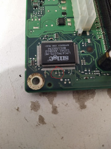

I recently got this fujtisu D1520 mobo. It posts but post card shows no codes being executed. I also spotted a missing component, which i suspect its the cause (besides that big scratch). Can anyone help my identify this missing component in red circle?

Reply 1 of 9, by weedeewee
Looks like a ceramic capacitor.
seems to be attached to pins 63 GP36/nKBDRST and 65 VCC
edit, same chip on https://theretroweb.com/motherboards/s/fujitsu-siemens-d1381 better photo shows a capacitor.
Do not ask Why !
Reply 2 of 9, by rasz_pl
looks like cap, while datasheet calls for resistor in some cases:
>Note 9: External pullups must be placed on the nKBDRST and A20M pins. These pins are GPIOs that are inputs
after an initial power-up (VTR POR). If the nKBDRST and A20M functions are to be used, the system must
ensure that these pins are high. See Section “Pins That Require External Pullup Resistor”
Reply 3 of 9, by kotel
After replacing that missing part with an cap, still no post codes executed. Even after repairing the damaged trace its still not posting. Before diving deeper into repair, does anybody know where the pc speaker header is located? I couldn't find t in the manual

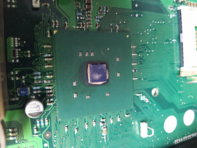

I'm suspecting the crack in the north bridge die the culprit of it not posting, so now i put this mobo aside and move on to next repair.

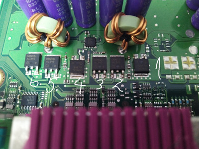

Decided to get back to reparing this mobo. Under further inspection i noticed that the VRM is getting really hot. Measuring without CPU, on mosfet 1 and 4 (look at the attached picture) I get around 11m ohms on gate to ground, 61 ohms on source to ground, 10m ohm on drain to ground. For mosfets 2, 3, 5, 6 i get 61 ohms on drain to ground, 14m ohms on gate to ground, 0,1 ohms on source to ground. Also saw an cracked solder joint form a coil next to 4 pin CPU power connector. Fixed it but same behavior. Also attaching a picture of the damaged NB. Even if the northbridge is chiped, it should at least do something, right? The POST card not showing any codes might be related to an unsupported BIOS. Had it happen on some boards. Any ideas?
