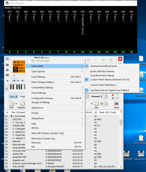

Can anyone guide on how to handle the two main quirks of mkII rom? If I'm not wrong one is related to battery detection causing pitch change, the second one is missing sounds cased by sound mapping discrepancies aka capital tone fallback.
I've seen seen GS reset proposed as a solution for both issue: Q, hold U and press Q, W.
The question is when is a good time to use the reset operation?
Reply 158 of 326, by EmperorGrieferus
markanini wrote on 2024-04-15, 14:39:
Right after the NukedSC played its intro animation.
Reply 159 of 326, by Falcosoft
1. It's enough the send a GM or GS Reset SysEx to cure pitch issue. If you use FSMP or Van Baso you can set them to send resets every time a new title is played.
2. The above key combo reset / GS reset cannot cure capital tone fallback related problems.
2a. To cure capital tone fallback related problems the simplest way is to send a GM reset. This way all bank select messages are ignored by mkII. But this way you actually disable all variation tones.
2b. The more sophisicated method that does not disable all variation tones is to use FSMP and its software Capital Tone Fallback feature:
You should click Main menu -> Instruments -> Custom Patch definitions and select Roland SCVA -> 'Roland SCVA-55' for melodic and 'Roland SCVA-55 Drumsets' for drum channels. Then you should also enable 'Use Patch info for Capital Tone Fallback' option.
