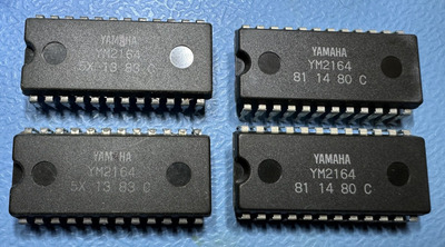

Reply 55 of 67, by florian3
rkurbatov wrote on 2024-03-12, 00:27:
florian3 wrote on 2024-03-12, 00:02:
I ordered the YM2164 from a supplier in China that has sold me some authentic Yamaha chips before. Fingers crossed…
The same thing. Lake Store or something like that. But that was YM3812 with strange label on them, though perfectly working.
I received YM2164 from two different sources (new and used).
I have not tested them, but they look ok (not that I have much experience identifying fake chips). Date code seems sane. The new ones are from AliExpress seller "InShop chip Store" and cost $8.40 per chip.
    369.09 KiB
    382 views
    YM2164

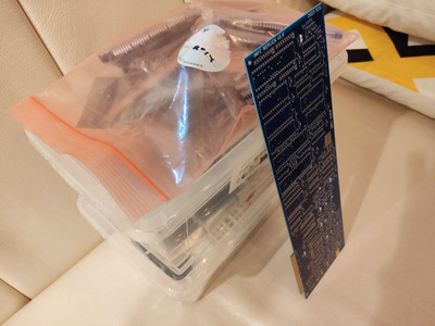

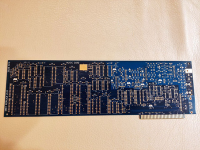

Reply 58 of 67, by florian3
I'm almost done with my build, missing a bracket and wire in matching colors for the ferrite core thing. Also just noticed that I soldered on the dip switches the wrong way, so it doesn't match the silk screen.
I can't get Compose and Playrec to run on my 486 DX33. With turbo enabled it complains about interrupt and without turbo it hangs a bit. I'll have to try on another system. Kings Quest IV however plays music with the card and sounds good.
Thanks a lot @SCG for sharing the project!
