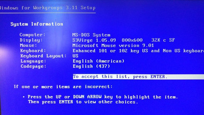

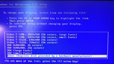

Reply 3 of 17, by StriderTR
To add to what Shponglefan said.
If you need to manually change settings or install video drivers for windows, then you navigate to the folder you have Windows installed to in DOS, then run setup.exe.
Normally, that's "C:\Windows\".
For example, here is my Windows 3.11 setup and how I installed my S3 Virge video drivers.
Once in the setup you can scroll down to "Display", click on that, then scroll to the bottom of the list and select "Other", follow the prompts.
Once you get in there and play around, it is indeed pretty straightforward. 😀

Reply 6 of 17, by Shponglefan
psaez wrote on 2024-04-14, 22:16:
Also, I got various graphics cards, for example, Gforce 4 MX 440, Voodoo 3 3000, TNT2, Gforce 3 ti 200... all of them AGP
How can I install drivers for those graphics cards on MSDOS 6.22 and Windows 3.11?
I believe that the TNT2 was the last nVidia card to have official Windows 3.1/3.11 drivers.
For the GeForce cards, you can use the SVGA driver patch from the Vogons driver library: https://www.vogonsdrivers.com/getfile.php?fileid=1914
I've been using it with a GeForce4 4200 Ti and Windows 3.11.
