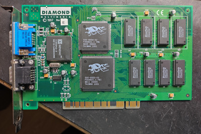

Hi,
recently i bought Voodoo 1 PCI graphics card, and the seller sent me the videos and photos of working card. When arrive, i noticed one missing SMD capacitor on C101, and i didn't want to turn on the card without this little cap (even though it would work without it). I have order all 10 new caps 10uf 16V, and replace old ones. Of course, i checked continuity of positive and negative poles of every cap, and it was all perfect (i was afraid of solder bridges beneath those tiny caps). I also bought "working" Asus K7V slot A MBO with Athlon 600, and i've tried this voodoo on this "new machine"! The MBO gave me 1 long and 3 short beeps, so i thought the board is faulty. Then i tried voodoo on 4 different motherboards, but on every single one i had beeps (vga fault)???
Does anybody knows what i did wrong, when the card was working before "recapp". I'm not newbie with soldering, and i did this at least 2000 times before.
Thanks in advance

Did you use a 2D VGA card in conjunction with the Diamond Monster 3D? The Voodoo Graphics (and Voodoo II) are 3D add-on cards.

No, just Voodoo alone. Do i need to add another VGA card to PCI slot for voodoo to work, or did i misunderstood You? I have never own a Voodoo card before, and i don't know 🙁
This is the card i tried (in attachment)

Reply 4 of 14, by Vagabund2k
butjer1010 wrote on 2024-04-16, 20:04:
You need another 2D capable graphics card; Voodoo 1 and 2 were 'only' expansion cards that took over the 3D part. Typical and contemporary choices would be cards from Matrox, Nvidia (Riva 128/TNT/TNT2), or S3 Virge. The two cards are then connected via a loop cable, and the monitor is connected to the Voodoo. In 2D mode, the image is then passed through the Voodoo to the monitor via the loop cable.
Reply 5 of 14, by butjer1010
Ok, officially, i'm an idiot!!! I didn't know that, and of course, when i added another Graphics card, it worked perfect!!!
Thanks a lot, i should ask this question before, it would save me some nerves 😀

Voodoo1 is speed sensitive, around 500-600MHz is where you start getting into trouble

What rasz_pl is saying is that you should be mindful of your CPU frequency. From my experience, Voodoo 1 runs just fine on anything up to 300 MHz or 66MHz FSB in general, but as soon as the FSB is raised to 100MHz or you start going south 450-500 MHz, all sorts of weird glitches start showing up. Keep that in mind, as you may need to move to a slower system, typically any of the early Pentium II or late K6-2, III and + CPUs will be more than enough to push as much out of the card as possible.
