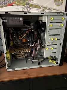

Long time reader, but finally had to bite the bullet and create an account... sorry for another one of these posts.
I've been gathering parts for a while to build a Win98SE late 90s gaming PC. Now I'm getting the full experience with a PC that won't do anything. When I turn it on all the fans spin up but I get some beeps and then no picture (although the monitor does wake up from power save mode). I now suspect that the motherboard is bad, but I've reached the end of my troubleshooting capabilities and I'm wondering if anyone has any ideas.
The attachment IMG_1789.JPEG is no longer available
Specs:
Motherboard: ECS K7S5A (v3.1)
CPU: Athlon XP 1800+ Thoroughbred (with NOS Cooler Master cooler)
GPU: Nvidia Geforce4 Ti 4200 (have also tried ATI 9600XT)
Memory: Varying amounts, from 1 512mb, to 1 256mb to 2x256mb
PSU: Brand new EVGA 500w
Troubleshooting:
  • Monitor/VGA cable works with my laptop
  • Reseated CPU, tried multiple memory sticks that I'm told have worked previously (I have no other way of testing DDR1 memory)
  • Replaced CMOS battery, reset CMOS multiple times
  • Went down the path of assuming my GeForce4 GPU was bad. Same behavior with ATI
  • POST test card says PSU is good (not surprising given that it is new)
  • Boot with everything disconnected except CPU + memory: 7 beeps (I believe this is asking for a GPU) and FF on the POST test card
  • Boot with CPU+memory+GPU: one short beep, followed sometime later by another short beep followed by 2 short beeps (I think...). End up with 85 on the POST test card
I'm having a hard time interpreting the beeps and POST codes. I'm not sure how the beeping is supposed to be separated, but it seems like it's pointing to memory issues. Which I guess could be the problem, but I would be very unlucky to have so many bad memory sticks. Also, if I read the description of code 85 it doesn't really help me troubleshoot...
"Memory size check done
About to display soft error and check for password or bypass setup"
Any ideas??

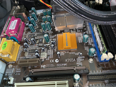

Reply 2 of 23, by Repo Man11
In the upper left of the photo I see what appears to be a capacitor with a domed top which indicates that it is failing. That power supply ought to get this system to POST, but 20A +5 will leave little margin for error and could be an issue.

Reply 6 of 23, by zPacKRat
As stated, the caps look suspect based on the quality of pics. and keep in mind these ecs boards while somewhat versatile, they were considered throw away boards. If memory serves me, I got mine for "free" at the local Fry's on a combo deal. I had a barton overclocked on one using 2 strands of wire from an ethernet cable, and the fact you can use sd or ddr ram is kinda cool too.

Reply 8 of 23, by Steage
CMOS battery is brand new... I've tried a couple now.
Good catch on the capacitor. I'm not that calibrated but I was assuming it wasn't bad enough yet.

Reply 10 of 23, by technokater
I had a K7S5A with exact the same issue and for me it was the capacitors. They didn't even look bad. On the other hand I had a MSI K8T Neo board with all CPU VRM caps bulging that was working 100% fine... Another issue I had was a corrupted BIOS. I had to reflash using an external programmer and voila the board came back to life.
Reply 11 of 23, by majestyk
All the green crapacitors should get replaced, even if they _seem_ to be o.k.

Reply 15 of 23, by momaka
I also have a K7S5A motherboard, though I never really did anything with it (was a freebie from a PC repair shop about to throw it away), other than finally figuring out how to make it POST several years ago. In my case, the board would NOT POST with any DDR(1) RAM of any kind. I tried high density & low density modules of various capacities, and result was the same - none of them got the board to POST. Finally, I decided to try some SDRAM. Miraculously, the board appeared to work fine with that. Thought it must be a fluke incident, so tried with the DDR RAM again, but same thing - no POST. Interestingly enough, I initially thought the CPU I used was the problem, since it was a Duron Applebred 1400 (Thoroughbred B) core and perhaps too new for the board. But that wasn't the case - with the SDRAM, the motherboard booted fine with the CPU.
Unfortunately, I never did anything more with the board since then. I did check absolutely all of the small SMD components on the board to make sure nothing is out of the ordinary... and it wasn't - no chipped resistors or caps to cause the issue that I was seeing with the DDR RAM.
From what I've read online, some of these board can be extremely buggy with their original BIOS. If you have the means to program the BIOS externally to a newer version, perhaps that might resolve your issue?? Or not, IDK.
As for the caps: yes, you should change all of them. I see OST RLP series and G-Luxon LZ. The latter are pretty terrible... though sometime they are still OK, like they are on my board (not that I would leave them on there when I do get to making a build with that board.)
The bulging cap on the top of your board may or may not be the cause of your issues... though I suspect that it isn't, since that cap is on the 5V rail before the CPU VRM high side caps (separated by an inductor, so HF noise from CPU VRM shouldn't be making it back to the rest of the board.)

Reply 17 of 23, by Steage
An overdue update to this thread for posterity:
PC is up and running, albeit with a PCI Geforce FX5200 that I found for cheap.
I now have 3 Socket A motherboards (oops) and neither of my AGP video cards work in any of them. So I've come to the conclusion that I have 2 bad cards... I guess I have been eBayed.
I started down this path to play with hardware and learn, and I've had plenty of opportunity to do that, so mission successful.
