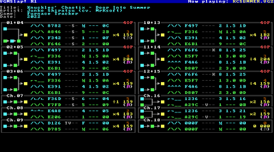

I recently released VGMSlap, a player for OPL1/2/3 VGM files under MS-DOS. It is certainly not the first and definitely will not be the last VGM player for DOS - but it's mine!
16.34 KiB
523 views
I wrote it as a learning experience for both MS-DOS programming and C in general, so it might still be rough around the edges as I'm still pretty inexperienced. There's definitely room for major performance improvements and more features. However, it does do what it says it does, and I think that warrants a public release!
Compared to some of the other players available on DOS, benefits of VGMSlap include a visual channel display in a colorful 80x50 screen mode, support for playlists, and the ability to play Dual-OPL2 VGMs with the correct Sound Blaster Pro 1.0 panning even on OPL3. It should run okay on a 386 or higher with VGA (as I said, definitely room for performance improvements!). Cards with OPL2, Dual-OPL2 and OPL3 are all supported.
VGMSlap is open source and distributed under the MIT License, targeting Open Watcom C 2.0. Code and releases can be found on GitHub: https://github.com/MrKsoft/vgmslap
I would be interested in hearing your experiences with VGMSlap and (constructive) criticism on fixing bugs and making improvements. Enjoy!

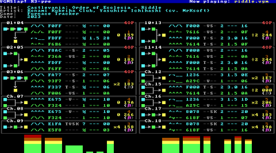

R2 is now available, with lots of fixes: https://github.com/MrKsoft/vgmslap/releases/tag/r2
  • Rewrote screen update code to only write screen areas when the actual chip data changes instead of refreshing the whole thing. Performance is only marginally better overall, but it is much more responsive on under-specced systems.
  • OPL2 detection now actually works outside of emulation.
  • Disabled interrupt timer mistakenly left on while decompressing VGZs, now it completes a lot faster.
  • Improved handling of VGMs that are missing "end of song data" command (0x66).
  • Fixed a mistake in sample position calculation; all commands advanced the position counter even if there were multiple commands in one sample. This may have been a contributing factor to the DIVIDER configuration setting making complicated VGMs sound weird, so setting a higher DIVIDER should be less of a problem now!
  • Fixed issue where playlist entries would fail to load on some systems.
  • Fixed OPL register/data write delays being reversed.
  • Error messages related to file loading are more descriptive.
