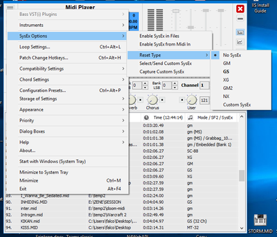

Just a side note, you can do both with FSMP both for Midi files and for games when FSMP is used as a Midi router.
1. Reverb:
You can change only the SysEx reverb level and leave the reverb type on default but you can also change the reverb type/preset.
21.33 KiB
967 views
2. Disable receiving SysEx messages:
You can disable receiving SysEx messages both from played Midi files and from Midi input.
Moreover you can also set the Midi reset to 'No SysEx' that disables sending SysEx resets but at least sets default instruments and contoller values.
BTW, you can also set default Custom SysEx type as reset type where the modified voice reserve SysEx can be set.

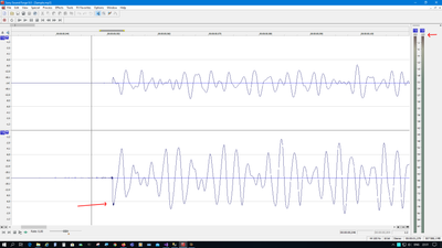

So, what's up with the low volume? I remember someone else bringing it up, but I cant for the life of me, find it again.
So I have my Sc-55 MK1, finally plugged in, so switching between um-one and nuked is easy.
I guess I could just increase the windows audio volume and lower game sound in the games settings.
Or is emulating the volume knob an option?

Until FP32 output PR is accepted you can try the floating point test version that has non-halved volume output:
https://github.com/Falcosoft/Nuked-SC55/relea … _float_test.zip

This is small selection from Descent 2 credits theme. I know, I could've mute drums so I wouldn't need to cut this part out, but hey.
It does not sound and does not look like clipping. There is a glitch-like problem at the very beginning of the right channel but it's not because of sample overflow/clipping (the amplitude at the glitch is about -5 dBFS). There are louder problem free samples in the recording. Maybe a buffer underrun or another bug?
Just to be clear: You also hear it real-time from the synth not just on the recordings, don't you?
81.99 KiB
