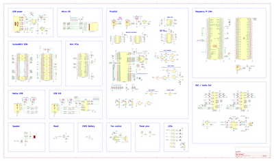

Update: more or less done with the schematics. Have to carefully go through all parts and assign footprints and check JLC for availability, but here's a preliminary snapshot:
997.95 KiB
745 views
tinyllama3-prototype.pdf
1.28 MiB
10 downloads

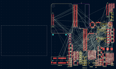

Reply 18 of 32, by Eivind
Time to play Component Tetris...
590.95 KiB
507 views
The shape to the left is 85x56mm, same as the Raspberry Pi. Dunno if I'll be able to fit everything into such a small area, but I thought it'd be fun if I could.
