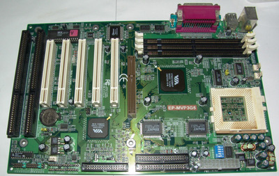

I recently bought this board a Epox MVP3G5 with 2Mb L2 so when it arrives Ill be testing it out with both a K62 550 @ 600 and a K63+ 570 @ 600, so I may step into this thread with some results and benchmarks of how the board performs, I have a spare Ti500 that I will be using along with a Voodoo5.
The attachment Epox EP-MVP3G5.jpg is no longer available
Been a long while since I last overclocked on a Super 7 so I doubt I will hit some of the amazing scores here but this board should post some terrific scores without any crazy tweaking.

Just go for 112*5.5 The CPU should be stable not sure if the motherboard will.
I am hoping you can get into club 5000 with that board! 😀

I'm curious to see if the K63 or K62 will pull ahead, the chips can be a bit funny with some L2 cache, I've also read that this board performs best when limited so 384Mb of ram using single rank SD-133 sticks and can pull some crazy cache speeds with that config. Its no slouch with 768Mb either but no crazy cache speed shenanigans.
Board is reported to be exceptionally stable at a range of bus speeds and was built for overclocking so the bios has a silly amount of settings including a clamp for AGP bus speeds to lock it to 66Mhz if needed.
The more I read about the board the more excited I am to get my hands on it.

Yes, I can confirm that mvp3 seems to really like single sided 128mb sticks. Though with a performance hit you can sometimes push that to dual sided. (Will be slower)

Unfortunately the mvp3g5 does disable the onboard cache when running FSBs above 100.
There is no way around it even with softfsb or CPU cool. But I managed to run my CPU at 4x133 with onboard cache disabled. Performance wasn't as good as with the ALI Chipsets

hmm which means the K6-3+ should pull ahead above 100 FSB due to its on die L2 cache.
I also wonder if its the BIOS disabling the cache or the chipset, if its the bios then possibly there is a modded bios or a way to mod it, I would think with 4ns chips that the cache would handle FSB above 100 quite well.

I know there is something weird with those boards and overclocking with cache on. They wont even run at 105MHz.
My MVP3GM has two 512kb 4ns chips and it can run 112MHz stable and not 124Mhz
You might need to modify the motherboard
Don't be discouraged, make it work and teach us 😀

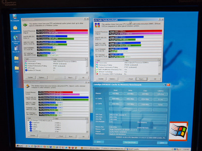

Figure I join the fun...
I have a couple boards at my disposal.
GA-5AX 5.2 (Chipset "E")
P5A 1.06 modded 1kohm (Chipset "G")
Both 512k Cache.

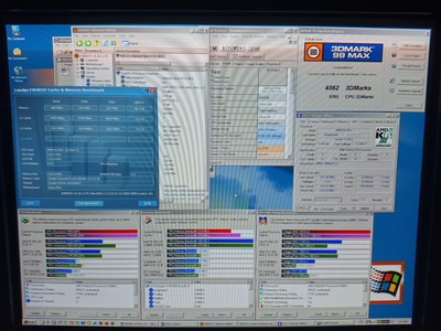

Reply 559 of 725, by Skalabala
That is a good CPU score for 633MHz
