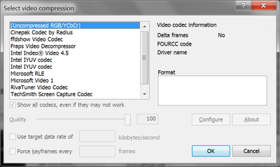

Reply 4 of 11, by Falcosoft
As others have said MCI (Media Control Interface) is still supported even on Win 11.
For audio MCI uses ACM (Audio Compression Manager) and for video VfW (Video for Windows) codecs.
But the installed default codecs are still the old ones so besides PCM audio and uncompressed AVI files MCI by default only supports ancient codecs (MS RLE, MS Video 1, Intel Indeo and such).
So you will need a proper Mpeg2/Dolby Digital (AC-3) audio codec and Mpeg2 video codec to be able to play Mpeg2 encoded videos through MCI.
So the problem on newer systems is not that MCI is missing, but the game most likely wants to install such audio/video codec(s) that are not compatible with newer Windows versions anymore.
As far as I remember ffdshow supported Mpeg2 audio/video and besides Directshow filters it also installed ACM/VfW codecs but I only used it on WinXP:

Reply 6 of 11, by Falcosoft
BEEN_Nath_58 wrote on 2024-05-24, 08:03:
Falcosoft wrote on 2024-05-24, 07:39:
As others have said MCI (Media Control Interface) is still supported even on Win 11. For audio MCI uses ACM (Audio Compression M […]
As far as I remember ffdshow supported Mpeg2 audio/video and besides Directshow filters it also installed ACM/VfW codecs but I only used it on WinXP and Win7:
https://sourceforge.net/projects/ffdshow-tryout/
I have LAV installed but still the game proceeds onto the QuickTime "low quality" videos. I got my Win98 machine and the game initially installs DxMedia with some app "Cinecore?"
LAV filters are strictly Directshow filters. Contrary to ffdshow LAV does not provide compatible ACM/VfW codecs that can be used through MCI.
For testing you can use VirtualDub that by default uses only VfW codecs for video. So you can check with it what kind of video codecs can be seen by MCI applications (Video-> Compression).
The attachment vdub.png is no longer available
BTW, ffdshow seems to be working perfectly on Win7. I cannot test in on Win 11.
