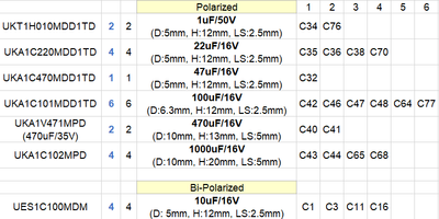

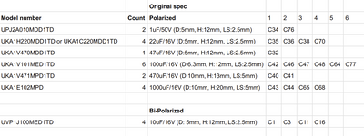

I've downloaded 2 different service manuals for the MT-32, however, both of them only list like 4 or 5 actual electrolytic caps in the parts list? But all the photos of the mainboards I've seen for the Rev 0 and Rev. 1 boards have more like 20 or 21 electrolytic caps on boards. I know some of them are non-polar/bi-polar caps. But I would think that someone somewhere has listed these all out to make it easier to purchase them together?
Or is there actually a kit someone has put together already similar to how I can purchase cap kits for old consoles and my arcade monitor chassis boards?
On the subject of the non-polar/bi-polar caps, has anyone just tried to use standard polarized caps putting the negative side to ground on the traces?
