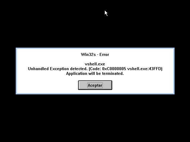

EarthSiege 2 vshell.exe error
First post, by badflame
This is version 1.13 of the game.
Once the game is installed, screenshot errors occur consecutively when trying to run it from Windows 3.11.
Any help?
    2.62 KiB
    1860 views
    2.49 KiB
    1860 views

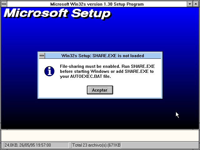

I suspect that the problem comes because, as the game's technical information text file indicates, it recommends installing the version of Win32S that is included on the CD itself.
But it turns out that it doesn't allow you to install it because it says that before loading Windows 3.11 you must load SHARE.EXE to install it. I tried running SHARE.COM which includes FreeDOS, also fakeshar.com from Vogons. They load into memory and then I run Windows 3.11, but I still get the same message, as if it doesn't recognize that the program has been run.
Anyway, I'm not sure either, since my version of Win32S is 1.30.172.0.

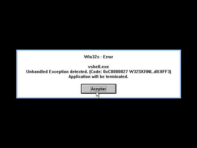

    5.86 KiB
    1798 views

Reply 13 of 32, by xcomcmdr
I tried it again, and to pass the Win32S error message, you need FAKESHAR from the Windows 3.11 guide: Windows 3.1x DOSBox Guide
You can remove it once WIN3S is installed. I don't see it in my AUTOEXEC section.

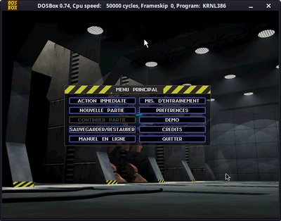

Anyway, here it is running inside DOSBox with WfW 3.11 and WIN32S in the screenshot below. Back in the day, I played for hours without any issues. Same with other games that require WIN32S.
An important correction to the config above:
[cpu]
core=dynamic
cputype=pentium_slow
It will *CRASH* instantly if you use core=normal !
BTW, WIN32S is the absolute limit of what DOSBox supports.

Reply 17 of 32, by badflame
xcomcmdr wrote on 2024-07-26, 14:40:
Yeah, Windows 95 is not supported.
But all Win32S games work just fine in my experience. And this has been the case for at least a decade.
xcomcmdr I have replaced my system.ini with yours, but the initial error VSHELL.EXE still appears
I would like to point out that if I use from DOSBox core NORMAL, when I double-click on the icon to launch the game it does nothing. In AUTO or DYNAMIC the game launches but produces the error VSHELL.EXE
I don't want to have confused anyone when I talked about the error that occurs if I try to install Win32S from the CD (to replace my own), which is when it requests SHARE.EXE. This is another error different from the game's own and it addresses the possibility that the game specifically requests the Win32S version that it includes and is not compatible with any other version, even if it is more modern. However, it has been impossible for me to verify this, since as I have explained previously, I have executed several versions of SHARE and the installer does not recognize it. In addition, my system.ini also includes the driver device=vshare.386, which should replace it.
Since it obviously works for you, my question would be: what version of the game do you have? 1.13 or 1.11? Does your CD have a "spanish" folder?
Reply 18 of 32, by jmarsh
Are you sure you tried with cputype=pentium_slow? "pentium" on its own is not a valid type, and the errors in the screenshots look like they are page related (addresses very close to end-of-page boundaries).
Reply 19 of 32, by badflame
jmarsh wrote on 2024-07-26, 16:55:
Yes, I have tried both "pentium_slow" and "486_slow", with the same result.
