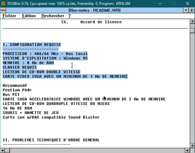

Your later version *requires* Windows 95. Here is the French README:

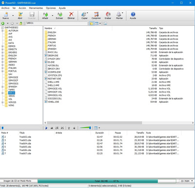

xcomcmdr wrote on 2024-08-07, 14:41:
Well, as you can see in the CD-Rom file tree, the disk has a specific directory with files for Windows 3.11. Also a Win32s directory that is exclusive to that version and not compatible with Win95.
On the other hand, the game installer detects the Windows version and installs the game. The problem arises when running it, with that vshell.exe error.
I think that, apart from the information in the README, it is quite obvious that the game is designed to work on Windows 3.11. Another thing is that it can work from DOSBox, which it seems not.

Reply 27 of 32, by xcomcmdr
I installed your version without any issues, but on launch it just does nothing.
The previous version worked fine with DOSBox.
I suspect that the folders you mention are merely artifacts from the previous version. The fact that it does not run anymore only confirms what the README states clearly: Windows 95 is required.
I really don't think that DOSBox is at fault here.
