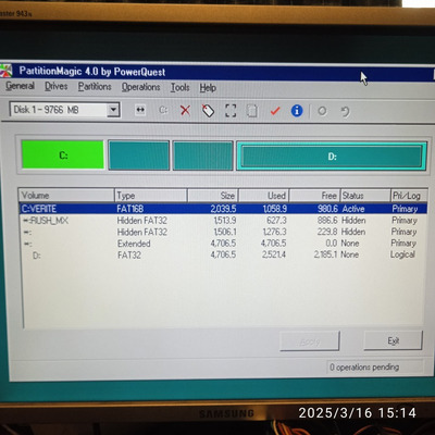

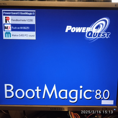

Hi Spitz.
I can't reply to a private message.
I'm sending the photo here.

Reply 47 of 47, by Postman5
CiZ wrote on 2024-09-04, 21:27:
1. Do you have a tested way to prepare DualBoot WinXP / Win98?
I think this is the most beautiful way to boot different operating systems.
So their system files are always separated.
