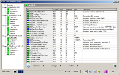

Reply 34 of 46, by soggi
This still sounds weird to me, can't remember that I saw such a behavior by HDDs over the decades - I saw it, but with SSDs.
Nothing lasts forever, everything will break sooner or later, no matter if mechanical or electrical, even the latter will have defects of the material after (excessive) use and as said HDDs have unlimited write cycles in theory, especially consumer SSDs have been far from that.
HDDs could last very long, if you have an eye on the temperature, it should be relatively stable on not to high ranges.
I have no problems with HDDs running more than ten years nearly every day, the HDD (TOSHIBA MK8034GSX) in this IBM/Lenovo T60 works for ~18 years now, one external has even more hours (see screens below) - I guess a SSD would have already died for several reasons.

soggi wrote on 2024-10-01, 02:01:
Temperature, power cycles, running hours, air pressure, and noise on the power line are all factors that can affect their life.
I've seen quite a few bad HDDs originating from systems with cheap crap PSUs, and in my experience with cheap PSUs, I've also had a few HDDs run hotter overall due to dirty power from the PSU.
I see those drives at 20k and 30k hours, respectively... which isn't a whole lot, but it's not that little either. Actually, it's a pretty average figure for a home desktop PC that's been ran for a few hours every day on average. And one can tell it was a home desktop PC because of the high number of power cycles. Work-related desktops rarely get power-cycled and typically have twice those hours with half the power cycles or less. Most of my used HDDs are around that range. Now, my personal HDDs that I bought new, have a lot less hours and even more power cycles, as I tend to standby/sleep the PC when I anticipate I'll be away from it for more than an hour... especially in the summer, when I don't want to add more heat in the computer room. At winter, I tend to be a lot more lenient and sometimes keep my system running all day so that it keeps the computer room a little warmer. 😀
Speaking of high power-on hours, my highest is from a 100GB Hitachi Deskstar 3.5" desktop IDE HDD - it has over 100k hours at this point. No bad sectors so far, though. And before anyone thinks to say that perhaps this HDD counts the power-on time in minutes rather than hours (yes, I have a few HDDs like that), I've checked and this HDD properly counts the power-on time in hours. That's over 11 years of constant (24/7) uptime. Doesn't surprise me, though. I believe I bought it back around 2013 or later and got it with close to 100k hours at that point. So I've put maybe 2000-3000 hours on it and it rolled over 100k.

momaka wrote on 2024-10-01, 17:03:
The two HDDs on the screens are (as said) the T60 internal and the oldest of my 2.5 external ones (counts up to ~ten years)...I also have other HDDs in other computers, which I used earlier (and longer) but can't get a screen of so fast...I think one, two or three have more hours...so yes, the values aren't extremely high, but the highest I had a hand on.
