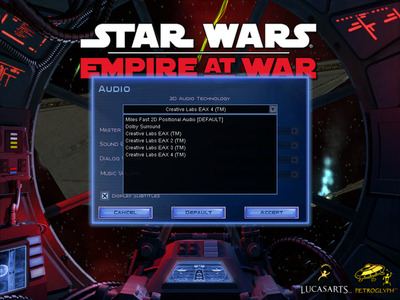

I've been testing a few games that had no specific EAX version listed on our wiki, and came across this in Star Wars: Empire at War:
The attachment SWEmpire_EAX.jpg is no longer available
Was pleasantly surprised to see all the supported EAX versions plainly listed under Audio Options. That's a somewhat rare occurrence, and I usually need to check the version of eax.dll that ships with the game, or open the executable in a hex editor to determine which EAX version(s) a game supports. Kudos to the Empire at War devs for being so clear!

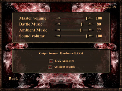

Reply 103 of 1245, by Joseph_Joestar
I recently did some testing with the Painkiller game series. To my surprise, they kept EAX support even for Painkiller: Redemption, which was released in 2011:
The attachment Painkiller_Redemption.jpg is no longer available
I'm not very familiar with these games, and from what I've read, they seem more like standalone expansions than proper sequels. But it's still interesting that the developers continued using EAX for so long.

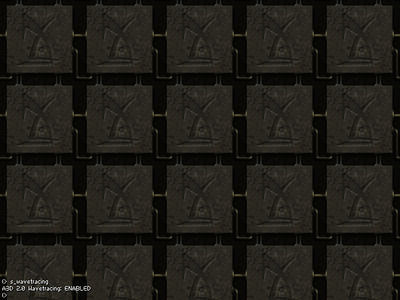

The A3D 2.0 support got me a bit curious, so I started Deus Ex on my Turtle Beach Montego II card (Aureal Vortex 2) but it looks like that game only supports A3D 1.0 per the log file. I tried a couple of different drivers, including the latest 2048 version, but I couldn't get A3D 2.0 to be detected. It's interesting that Deus Ex left out A3D 2.0, while X-COM: Enforcer which came out next year did support it. I was wrong, A3D 2.0 does work in Deus Ex, see below.

Actually, it looks something went wrong when I was upgrading from an older version of Dell drivers (it's a Dell OEM Montego II) to stock Aureal 2048 drivers which caused A3D 2.0 to not be detected. I just did a clean install of Win98SE using only the stock 2048 drivers from Aureal and A3D 2.0 worked fine in Deus Ex. It's correctly detected by the game and shows up in DeusEx.log:
Init: Aureal A3D 2.x 3D sound hardware found!
Furthermore, if you type in s_wavetracing into the console, you will get this:
The attachment DeusEx_A3D_20.jpg is no longer available
So yeah, A3D 2.0 does work in Deus Ex, though you may need newer drivers. I have tested Aureal's stock 2041 and 2048 drivers and both properly enable A3D 2.0 in Deus Ex. However, the older Dell driver only enables A3D 1.0 for some reason.
