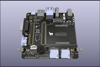

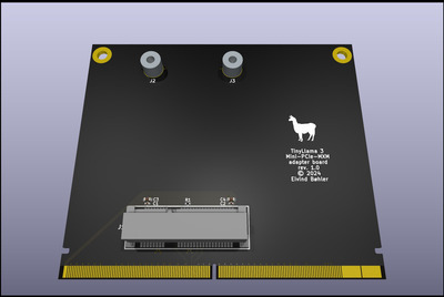

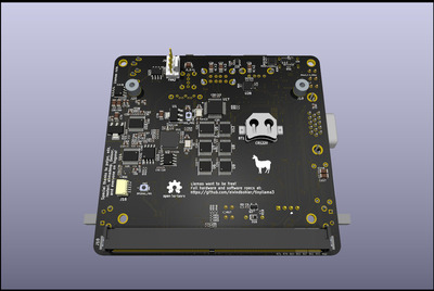

Reply 185 of 290, by Eivind
Update: Getting close to prototype ordering time again!
Added an I2C IO expander (connected to the Vortex) that controls 8 diagnostic LEDs, as well as an analog switch/mux that will let you set FAN2's PWM source as either the built-in EMC2303 fan controller IC or the MXM card (provided it has its own PWM controller).
Also made a simple Mini-PCIe-to-MXM carrier board.

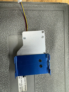

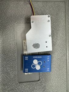

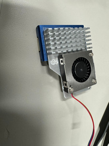

Reply 186 of 290, by ahmadexp
Spectacular. What a piece of art.
Eivind, just wondering, with regards to the fan on top (for the Vortex and CM4), I used the Raspberry Pi 5th heatsink+fan which costs less than $10 and works pretty well.
However, I had to cut and solder the connector for since the Raspberry Pi 5 uses a small 4pin JST SH (similar to the Qwiic one) with the following pinout:
Pin1 5V
Pin2 PWM
Pin3 GND
Pin4 Tach
No big deal if you do not see value in it as I can always cut and solder 4 wires 😀
Reply 187 of 290, by Eivind
ahmadexp wrote on 2024-10-01, 06:30:
Spectacular. What a piece of art. Eivind, just wondering, with regards to the fan on top (for the Vortex and CM4), I used the Ra […]
Pin1 5V
Pin2 PWM
Pin3 GND
Pin4 Tach
Thanks! 😀
As far as I can tell, the Raspberry Pi company went with a completely non-standard pinout for that fan, which doesn't exactly make it super compelling to use on this board.
I'm curious though, did you mean you only used the fan, or the heatsink as well? Isn't that specifically shaped to fit the RPi5 board and chips?

Reply 188 of 290, by snipe3687
Eivind wrote on 2024-09-30, 21:48:
Update: Getting close to prototype ordering time again! Added an I2C IO expander (connected to the Vortex) that controls 8 diagn […]
164.79 KiB
1041 views
304 KiB
1041 views
320.53 KiB
1041 views
This is such a good idea! It’s so much more flexible this way with the MXM slot. I have an old 980m laying around 😉

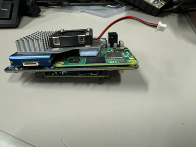

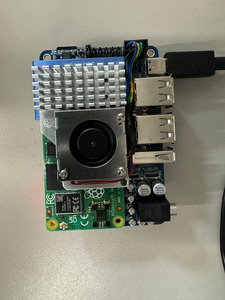

Reply 189 of 290, by ahmadexp
Eivind wrote on 2024-10-01, 06:58:
Thanks! :) […]
Pin1 5V
Pin2 PWM
Pin3 GND
Pin4 Tach
Thanks! 😀
True. This is less compelling since it is proprietary.
With regards to the fan and heatsink, I used the complete set. Refer to the attached pictures.
Reply 191 of 290, by Eivind
cursedverses wrote on 2024-10-02, 07:14:
If that connector is voltage compatible - and just not pin compatible, it wouldn't take long to poke the pins out of the header and rearrange them, no?
The Pi5 fan uses a JST-SH 1mm pitched plug - not the Molex 2.54mm pitched plug (mfn.47054-1000) that's standard for 4-pin PWM PC fans. So it's not as simple as rearranging the connectors in the plug.
While I do like the idea of supporting this heatsink/fan combo without replacing its plug, there's one major drawback as I see it - we already have a JST-SH connector on the board (the I2C connector). Putting another exact same connector on there which does something completely different and non-standard (and might do damage if you mix up the two), isn't super appealing to me. 😀
TinyLlama 3
ITX-Llama motherboard
TinyLlama SBC
Reply 192 of 290, by ahmadexp
Eivind wrote on 2024-10-02, 08:55:
I see your point. Worst than all is that if you plug a Qwiic device in this connector, you might blow it up since you put 5v instead of ground and ground on one of the I2c lines.
Just to be clear, I did not mean to get rid of the old connector, just adding the JST-SH right beside it.
Reply 193 of 290, by Eivind
ahmadexp wrote on 2024-10-02, 22:29:
Exactly, not worth taking the risk imho. 😀

Reply 194 of 290, by Eivind
Update: Revision 3.3 prototype boards + MXM adapters ordered! By kind suggestion from @sdz, I added some ESD protection diodes to the HDMI connector, otherwise the board is the same as in the renders above. Will update here when I get what I'm hoping will be the final revision in hand. Fingers crossed that everything will work out, especially the USB PD subsystem and MXM connector! 🤞
