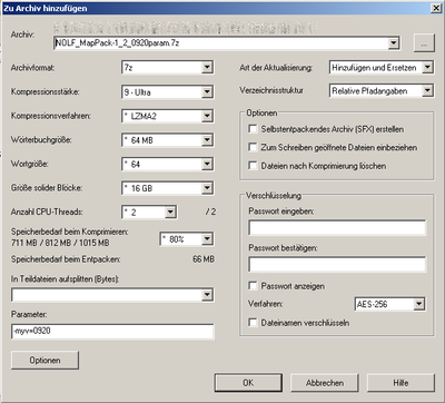

So I have to create the archives using the switch -myv=0920, I guess!? I always mark the files followed by right click -> 7-Zip -> Add to archive... and then there's a field for parameters. I tried both parameters (-myv=0920 and -myv=2300) and w/o and all three archives have the same MD5 sum (5f1a2ab5a2ff6506319dbff0e399007d). So this doesn't help.
Did I something wrong with the parameter? I want to know what's the latest possibility/version to create LZMA2 compressed .7z archives which are compatible with 7-Zip 9.20. As I don't have a working Win9x system, I can't test the archives myself with 7-Zip 9.20 in such an environment. Can someone test these please? Despite I guess all three are the same, I'll upload all...

Reply 1 of 12, by Stretch
I was able to extract all 3 archives with 7-Zip 9.20 in Windows 95. The test archive function in the right-click menu also passed on all 3 archives.

This is weird, why they write then that I need a parameter to create compatible archives!? As said, I guess all three archives are the same (same MD5) so the parameter didn't work at all...
So I can repack all files with the latest version of 7-Zip (24.08 at the moment).

Reply 5 of 12, by maxtherabbit
I'm not aware of any changes in the 7z format which broke backwards compatibility. I have yet to encounter a 7z file which would not extract on my win98se machine.

Reply 8 of 12, by bakemono
maxtherabbit wrote on 2024-10-14, 22:56:
A build of 7ZA (command line util) from 2006 barfs on a lot of 7z files these days, saying "unsupported method", so there must have been changes since then at least.

Reply 12 of 12, by maxtherabbit
bakemono wrote on 2024-10-15, 16:28:
Ok but those same files extract on gui version 9.20?
