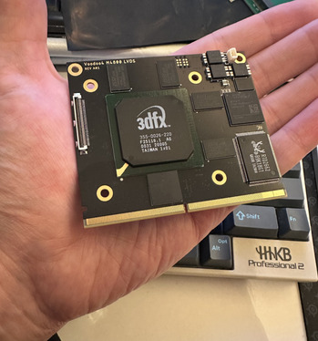

In addition to the Vortex86EX SOM and CM4 (not mandatory, but enhances the system greatly), you'd still need to buy the graphics card. As of right now, we have these options:
1. A Mini-PCIe-to-MXM adapter + a Mini-PCIe card; that'll be the Vortex86VGA (slow, but ok for 2D DOS games, ~$50) or one of the SM750-based cards (no 3D, but better 2D performance, ~$150-200). I think there's also cards based on the AST1400 IC, haven't tried those myself but supposedly they also work fine.
2. @sdz's Voodoo4 MXM card. No idea yet what the final cost of these is gonna be, first step is getting everything working. I'll be testing the MXM-equipped TinyLlama and this card soon.
3. Since the MXM "platform" is very capable, we might be able to make some custom, older PCI-based graphics card recreations down the road. I know @Deksor played with this idea a couple of pages back in this thread. Theoretically very doable, in practice I don't know yet.

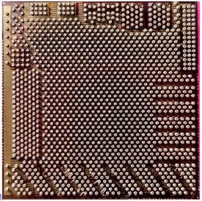

Slightly off-topic, but I thought it would be interesting nonetheless: I finally heard back from my contact at DMP - they've got […]
I finally heard back from my contact at DMP - they've gotten the silicon for the upcoming EX3 CPU back from TSMC, tested it and it looks good.
They're currently working on getting the substrate for the IC just right, supposedly it'll be in the ballpark of 4 months until the chip is done.
I also got a photo of the bare silicon die, with flip-chip balls attached and protective polymide coating removed.
706.32 KiB
2501 views
This is very exciting! Especially with the extra DMA potential!
Reply 205 of 290, by jamesfmackenzie
Eivind wrote on 2024-10-02, 23:06:
Update: Revision 3.3 prototype boards + MXM adapters ordered! By kind suggestion from @sdz, I added some ESD protection diodes to the HDMI connector, otherwise the board is the same as in the renders above. Will update here when I get what I'm hoping will be the final revision in hand. Fingers crossed that everything will work out, especially the USB PD subsystem and MXM connector! 🤞
Reply 206 of 290, by jerms
jamesfmackenzie wrote on 2024-10-06, 17:51:
Eivind wrote on 2024-09-25, 08:00:
706.32 KiB
2501 views
In terms of the EX3's architecture, I noticed an interesting clue in one of their YouTube vids recently, in that it now supports Windows 10. Which means it has the NX-bit, unlike any previous Vortex. So it's concievable that it's quite heavily revised. Of the current Vortex chips, only the DX3 supports Windows 7, even then, not W10. According to DM&P's own figures, the DX3 is 4x the relative performance of the EX - given the EX3 appears it will be more advanced again, it could be getting to really usable W98 territory. Or I could be totally wrong and the NX-bit is a trivial piece of microarchitecture to implement...

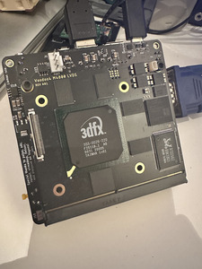

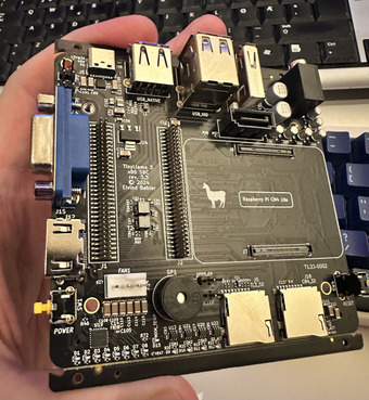

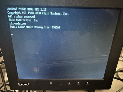

Reply 213 of 290, by Eivind
Been kinda busy these last days, but here's a quick update of my findings:
- The TL3.3 board looks alright, it does work (like the previous prototypes) and I can play games on it! 😀
- The MXM connector works with sdz's Voodoo4 card, I'm getting VGA and HDMI through MXM and out from the respective connectors on the TL board!
- My Mini-PCIe-to-MXM adapter works fine as well, tested with my SM750-based card.
- I think there's some kind of bug with my power circuit - It takes two pushes of the power button to turn on the board, one to power it down. I tried two different USB-C PD power bricks, identical result. Will investigate this further.
- My CM4 with eMMC works just fine even though the board also has an external SD card slot for the Pi. I guess that means you can use either the eMMC-equipped CM4 or the Lite version - I need to get one of those for testing.
- Haven't gotten to experimenting with the I2C IO expander and diagnostic LEDs yet.
- The SATA connector might not have been the best idea. I kinda forgot that SATA devices also require "SATA power", and there's obviously no ATX power supply with these power connectors at play here. What might be a much smoother solution is using an mSATA or M.2 connector. Problem is, there's no room currently on the board for such a connector. A good quality microSD card works very well though, so not sure it's worth pursuing really.
- I don't like the position of the power- and reset buttons. Will have to think long and hard about those, I do want them to be 90-degree ones, but they all have through-hole pins or stabilizer studs which would interfere with the MXM connector on the bottom side.
- My biggest concern right now, however, is PicoGUS's apparent lack of Win98 support. It works amazingly marvellous in DOS, but I'm really struggling getting either the GUS or SB mode working in Windows. Wish it had a WSS mode... 😁 Any and all suggestions are welcome!
Edit: a little bird told me that a WSS mode might be in the cards...
