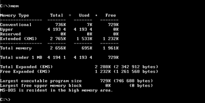

this in an ancient topic, but sometimes I still need to maximize conventional memory in DOS. Can you post some tips and suggestions in getting max memory free?
below are my best attempts:
1) With Qemm, 4DOS, Dosup, Nnansi, etc. : 635K free
2) With Qemm, 4DOS, Dosup, NNansi, vidram: 729K free
see attached the mem output
    59.83 KiB
    1142 views

If you already have 635KB free I don't see a point in continuing further. In practice 600KB is about enough. Quickly checking the threads here it appears about 618KB-620KB was what the largest games needed, and even back then a game that required that would be seen as an exceptional PITA and you'd probably use a dedicated boot disk or dos menu config for it.
Beyond just unloading unneeded stuff and using more sophisticated memory managers than what was bundled with MS-DOS (as you've done already), something available now but more difficult back then is replacing drivers and TSRs with something else that does the same thing but is more memory-efficient, and you've already done that too. In addition, Win95 DOS boxes are a trade-off in that the maximum possible free memory is lower, but certain drivers aren't needed at all like a mouse driver or MSCDEX, so fewer moving parts in freeing memory.
At some point if you do what you'd need to achieve more than you have already, you have a system that is no longer 100% IBM-compatible or breaks compatibility with MS-DOS. The vidram trick is already not IBM-compatible.
There are certain data structures at the bottom of conventional memory that take up a few KB and simply can't be moved.
Without any tricks on your system, do you have the full 640KB conventional memory? Some "modern" (late 1990s) BIOSes are of the sort that always steal 1KB of conventional memory to stash certain things and you can't do anything about it, so you could always just use a system that doesn't do that to prioritize your DOS gaming. Or is this an emulator; I can't tell.

Up to ca. 900 KB are possible without a graphics card.
MS-DOS then has to be "remote-controlled" from a serial terminal, via CTTY command.
That configuration was useful to compile large projects using compilers that didn't support XMS or EMS yet.
Edit: With CGA graphics, 736 KB of conventional memory are possible.
PC/XT users used this configuration once (in DOS 3.x days).
But they had to because they didn't have HMA (286+, DOS5+) to outsource DOS to.
An UMB card was technically available to them, but I'm not sure if they used it.
OS/2 can provide 736 KB, too, by limiting applications to CGA.
PS: In order to gain more than 736 KB and have graphics the frame buffer either must be relocated which involves well written VGA applications
which ask the BIOS/VGA BIOS were frame buffer location is or applications that support the alternate frame buffer region directly.
Or an exotic graphics card standard with a higher frame buffer region is needed.
Something exotic in the sense of TIGA graphics, PGC, Hercules InColor.
Not them, but something like them. A graphics hardware that has its frame buffer closer to 1 MB border.

Reply 8 of 13, by dos_user_since33
MAZter wrote on 2024-11-08, 14:13:
dos_user_since33 wrote on 2024-11-07, 20:59:
Pretty good amount of memory, how are you did this? Can you please provide zip file with set of configuration files?
Here are the config.sys and autoexec.bat. Config.sys vrega parameter is for Vidram, without it low dos memory is 635K
    files.zip
    665 Bytes
    42 downloads
