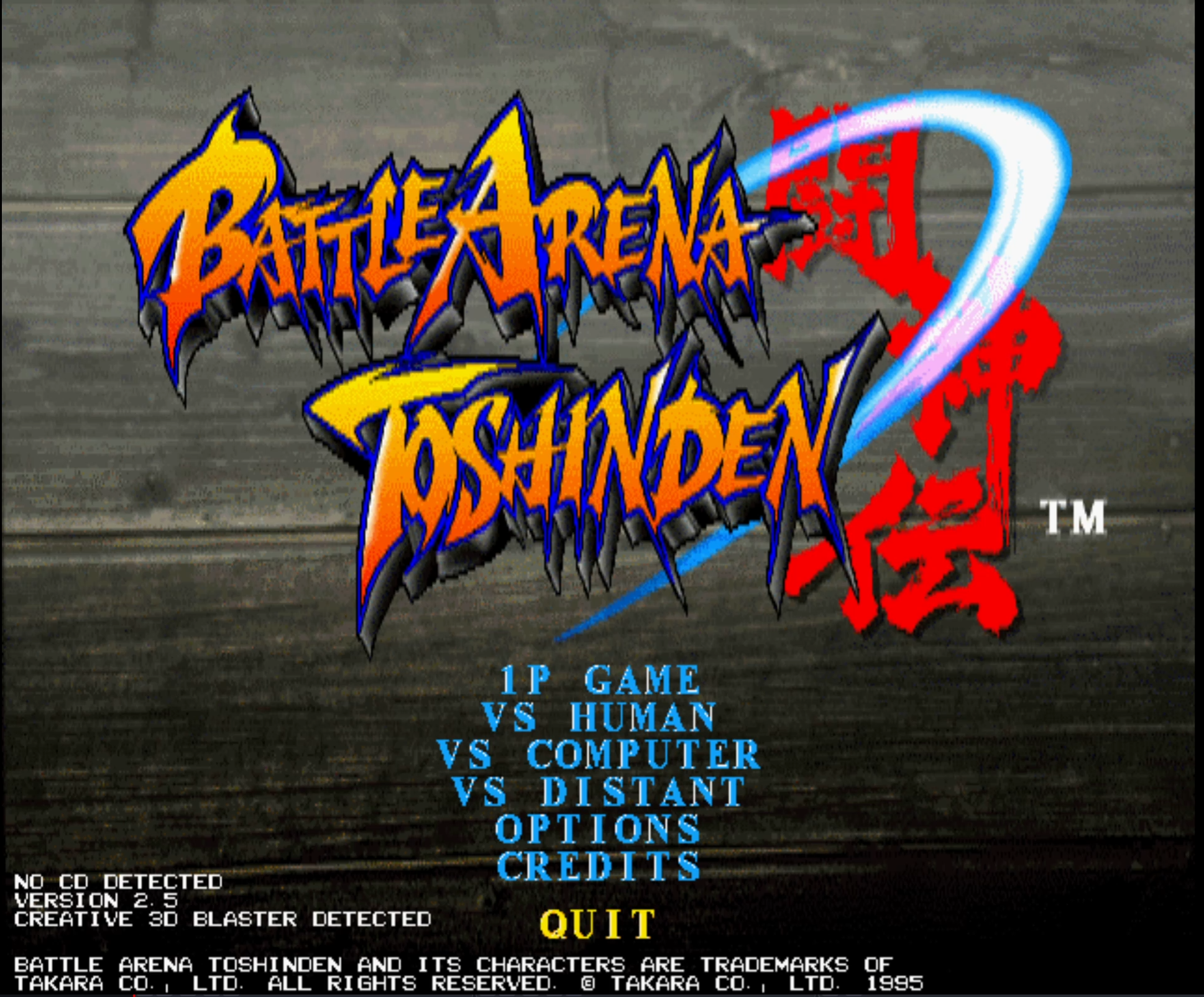

I don't really know how this is happening but Toshinden with RReady is reporting "3D Blaster Detected." I'll post a video early tomorrow morning or after midnight (if I'm still awake) here when the free data period kicks in. It's all front buffer rendering so full screen capture doesn't work. I captured it at 2560x1440 in a window. Here's a screenshot:
The intro vids and menu render in VESA modes. Managed to fix a few missing bits of RReady to support 8- bit mem writes to VGA RAM.
The game isn't playable and complains about a missing CD. I do have the 3D Blaster software CD (Disc 2) in drive D but it doesn't seem to detect it.
[EDIT] I think the menus at least should work on a stock V1000, even if it's not a 3d blaster pci.[/EDIT]

Figured out what was wrong with the missing cd. The tsdupgd patch contains the binary and cgl driver for the retail game. The cd I have is the Creative demo disc which is supposed to come with the card. It does come with a full copy of Rebel Moon. The demo disc is enough for development.
The 3d section crashes in the demo. It changes the mode to 640x480/15 and reads the pci registers for device ids, VRAM Phys Address and a few more things and then inexplicably crashes.
The 3dblaster under Win98se is unstable with Rendition or Creative drivers. The only thing that works reliably are the Win98se Microsoft supplied drivers. Unfortunately rredline doesn't work. Trying to run an rredline app produces a missing Rts.dll error. [EDIT] different errors with different games. [/EDIT]
