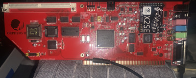

qz3fwd wrote on 2024-11-17, 06:36:
Behold the glory. Just need to find a red PCB 16MB SIMM!
That looks absolutely gorgeous!

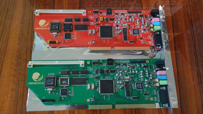

Reply 1135 of 1266, by atomeec
My card arrived today. I am so happy 😀 It works of course (only the joystick port is not yet tested). Merry Christmas (I doubt other thing I will buy this year 🤣)!
