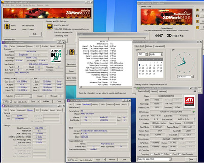

3DM01 run year 2021.
The attachment 4447.jpg is no longer available
The attachment SS=_cse_ide-sd8g.jpg is no longer available
The attachment K6-III+.jpg is no longer available
The attachment 3DM01_N.jpg is no longer available
The 3 body problems cannot be solved, neither for future quantum computers, even for the remainder of the universe. The Proton 2D is circling a planet and stepping back to the quantum size in 11 dimensions.

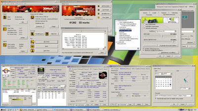

Reply 592 of 643, by DarthSun
Of course, RyZen is now also attack under Win98. He became the star. 😀
The attachment r3800xn7900gs4650w983dm01.jpg is no longer available
