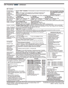

Reply 6 of 17, by megatron-uk
The 128ZV apparently has "colour space conversion" and "interpolation" features... that was about it for video acceleration at the time. It should play fine.
