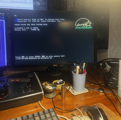

Hi,
I had this card for a long time in my 486DX2 system. Ocassionaly I had to clear CMOS to get the PC to POST. The electrolytic caps on the card seemed to have leak, so I replaced them all. Unfortunately recently the pc started to show just some colorful lines with cursor blinking in the middle of the screen and now it seems completely dead, there are many ceramic decoupling caps on the board could it be one of them somehow half shorted or something? When i measure the resistance between the +5V and GND I get 69 ohms, that seems odd to me. Could anyone with the same card try to measure that if they get similar values? Or any other ideas? With a different trident isa card the system works just fine. Any help would be great, these VLB cards are hard to get these days.
Thank you!
Lukas.

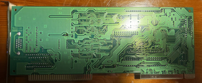

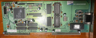

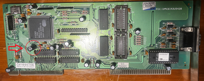

Reply 5 of 16, by anonyfous
Hi,
thank you guys for all the replies, here are the pictures of the card, the soldering of the electrolytics is not nice, but the contact is fine. Sorry for the reflections on the photos, but maybe youwill notice spmething.. I will try to inspect the main chipset legs under microscope. I have some eproms, so if anybody has contents onf the BIOS chip, I can try to swap it. not sure about the DRAM chips, where can I get those?
Thanks,
Lukas.
Reply 7 of 16, by Horun
Yes issues with the VESA slot are common. I would use a pink pencil eraser on the VLB card part and then clean with IPA. Inspect your motherboard VLB slots with a magnifying glass as gold fingers and sockets are prone to attracting crud (they do not corrode but attract it).
Looks like a Jaton VLB card by the layout. Cirrus GD542x VLB are actually quite common and a replacement should not be very expensive if need be...
What has become very rare is the S3 Trio64 based VLB cards, those are horrific in price if you can even find one...

Reply 12 of 16, by MikeSG
Is this capacitor around the right way? It looks like GND should face down.
The ceramics on this board would be 100% fine, unless they are have broken legs.
Reply 13 of 16, by rasz_pl
anonyfous wrote on 2024-12-20, 11:13:
rasz_pl wrote on 2024-12-20, 04:09:
Does it boot with both ISA and VLB cards together? Can you solder SMD?
Yes, it booted with both VLB and ISA cards just fine before.
Thats good bad! Means BIOS on VLB card is not being mapped correctly. Good because now we know what to fix, bad because it can:
- still be Cirrus Logic Chip
- just supply to VGA chip
- VLB connector
so we didnt really narrow much 😐
For Bios to be mapped into correct address couple of things need to happen:
- Cirrus Logic chip must have power
- CL chip must have solid connection to A[23:15] address lines, M/IO, W/R pins
- ISA part of the card must have good connection between SMEMRD# and 74LS244 chip hiding under the BIOS chip
Considering you had flickering colors previously I would also blame VLB connector and motherboard socket first. Try different VLB socket, use pencil eraser on VLB edge connector
>first, it worked fine, then ocassional CMOS clear was needed, then some crazy stuff on the monitor and a series of beeps (multiple beeps first and then the normal one beep and then the lines on the screen after that the computer booted), now it won't even post and is silent
Wait, no beeps with only this card doesnt sound right. Why would it work with another VGA card in ISA slot tho? Either it doesnt respond at all and another ISA VGA is free to load its own bios, or it responds erroneously/pulls data/address buss down somehow because of problems with power for example.
https://www.vgamuseum.info/index.php/cpu/item … logic-cl-gd5428 2A3UH100 Plus is rectangular pad facing down.
https://github.com/raszpl/FIC-486-GAC-2-Cache-Module for AT&T Globalyst
https://github.com/raszpl/386RC-16 memory board
https://github.com/raszpl/Zenith_ZBIOS MFM-300 Monitor

Reply 15 of 16, by anonyfous
MikeSG wrote on 2024-12-20, 15:04:
Reseating the BIOS can work wonders.
Guys, I removed the bios ROM, cleaned the socket, put it back together and it works! Thank you all!
