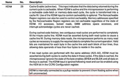

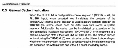

Reply 31 of 43, by analog_programmer
Deunan wrote on 2024-12-22, 12:59:
Leaving FLUSH# pin floating and enabling the function in the control register is a bad idea. IIRC that pin has no resistor and thus can randomly read as zero, which is active signal. This will cause the CPU to flush cache and it's not a free operation. It will slow down, possibly quite a lot if the signal ends up being asserted for every instruction executed.
Nope. Unconnected FLUSH pin don't cause floating signal, it's internally connected through pull-up resistor. RTFM.
The attachment FLUSH_signal.jpg is no longer available
As for KEN, it works in the opposite way. Wih KEN disabled in control register the cache is always enabled, not disabled. So in other words everything is set to cacheable. This is exactly why the CPU has 4 (and later ones even more) special exclusion zones that can be set up to be non-cacheable. To work around lack of proper KEN from mobo side. You just set these zones statically knowing what is and isn't installed in the system.
Unconnected KEN pin also don't cause floating signal, it's internally connected through pull-up resistor. Again, RTFM.
The attachment KEN_signal.jpg is no longer available

Reply 38 of 43, by DEAT
analog_programmer wrote on 2024-12-22, 11:15:
So, what is doing the "Cyrix cache enable/disable" option in the BIOS, if cache is permanently disabled by internal CPU connection and there is no KEN signal from chipset?
I just happened to have my M396F v2.7 mobo with a factory-installed Cx486SLC-40MP close enough to my test bench to try this.
The BIOS option enables BARB, according to cyrix.exe -q output.
Enabling FLUSH and keeping BARB disabled via cyrix.exe works without issues if I have the BIOS option disabled - didn't test it with it enabled.
Shareware Doom 1.9 DEMO3 timedemo with minimal screen, low detail, sound channels to 8 with a CT2290 and mouse enabled:
FLUSH enabled - 3139 realtics - 23.794 fps
BARB enabled via BIOS - 3520 realtics - 21.219 fps
The performance difference is noticeable enough that the DMX sound library pitch fluctuation with poor performance is significantly more audibly present with BARB enabled compared to FLUSH.
