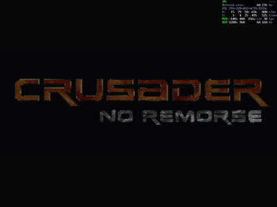

The demo starts well after running INSTCRUS.BAT to "install" it (sidenote: to anyone getting a black screen right at the startup of running CRUSADER.EXE, the game must be reinstalled to e.g. C:\CRUSADER even though the demo .zip file looks like an already installed to-go package), and I get to watch the intro FMV video ok:
212.21 KiB
505 views

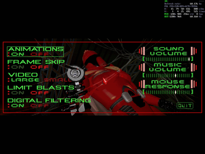

and get to the main menu, and settings, which I have at:
788.61 KiB
505 views

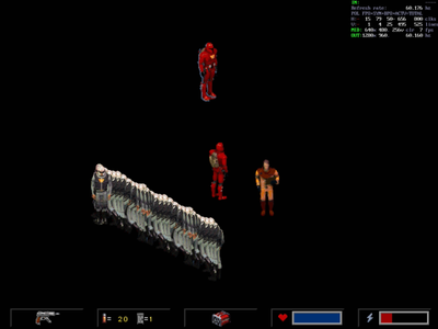

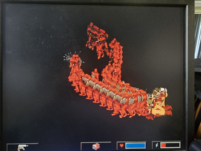

But when I start a new game, the game does start and runs OK, but none of the game background graphics get drawn, and as result, all the game characters sprites do not get cleared, and leave a moving trail on screen against a black background:

I have searched a fair number of topics about Crusader: No Remorse at Vogons and elsewhere, although could not find any mention about the above problem. Trying to search for "black screen" or "black background" or "trailing sprites" on the game left me clueless without hits. (black screen searches lead to other black screen issues about installation/CD, which I believe is not related here)
I've tried two different SVGA graphics cards: Hercules Stingray Pro (Ark Logic ARK1000PV, 2MB VRAM) and Diamond SpeedSTAR24 (Tseng ET4000AX, 1 MB VRAM), but both give the same artifact, making me think this is not a graphics card issue.
Also, I have "FILES=40" and "BUFFERS=40" in CONFIG.SYS as suggested by the README.TXT in the demo.
In addition to the built-in VESA BIOS support, also tried UniVBE 6.70 and the bundled UniVBE that the demo comes with, these do not at least have an effect. So I'm a bit clueless as to what might be the cause.

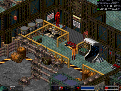

Finally, there is also a free demo of Crusader: No Regret at https://www.abandonwaredos.com/abandonware-ga … Regret&gid=1721 . Interestingly, that game works ok (tested on the 1MB Tseng ET4000AX), with backgrounds rendering correctly:

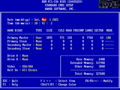

Any chance your bios was set to IDE LBA, block or 32 bit mode?
Yes, my BIOS is set to LBA mode:
123.19 KiB
205 views

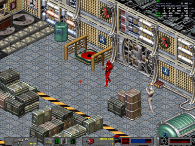

Though now I was thinking about testing a different hard drive mode to see if that might make a difference. So I redownloaded the demo from the same URL in first post to my CF card, and copied it to C:\GAMES\CRUS, and then ran INSTCRUS.BAT to install it to the default location C:\CRUSADER. (This is what I did the first time around as well, although tried different things in between in order to get there)
To my surprise, everything works out of the box, i.e. I did not yet change anything in the BIOS HDD settings.
462.28 KiB
198 views

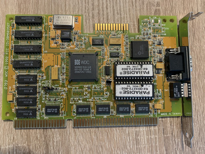

Some things are notably different compared to my test run. I have a different graphics card now installed in the system, a WDC WD90C31A-LR 1MB ISA graphics card:
1.65 MiB
198 views
You can search for the card at https://oummg.com/manual/adapters.html for details.
and I have upgraded the system from 16MB -> 32MB of RAM and 256KB -> 512KB of cache con this system. (Details here: Any hope of getting 64MB of RAM on my Cyrix 486 PC? )

Ok, I now found out the reason.
For good measure, I restored the earlier Hercules Stingray Pro (Ark Logic ARK1000PV, 2MB VRAM) graphics card in the system, with which I had problems before. And now that works as well. So it was not a graphics card problem.

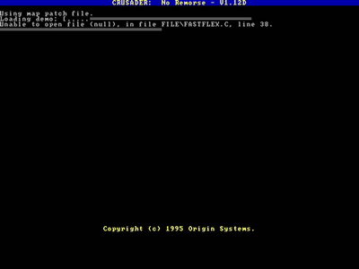

The root cause for the bug is: If one runs CRUSADER.EXE from the installer directory, the demo self-destructs, by corrupting its source data file STATIC/SHAPES.FLX.
In more detail, the way to blow up the game demo is:
1. Unpack the demo to e.g. C:\GAMES\CRUS.
2. Without installing the game, run C:\GAMES\CRUS\CRUSADER.EXE.
3. The game will very briefly flash an error at the loading screen:
72.69 KiB
139 views
showing an error "Unable to open file (null), in file FILE\FASTFLEX.C, line 38.".
After this the screen will go blank and the PC will hang. The problem here is that the game should have been installed first, but the game file structure and installer/launcher is a bit janky to not really make this obvious.
4. When this error occurs, the game launcher will also corrupt the file C:\GAMES\CRUS\STATIC\SHAPES.FLX. The file modification date will change:
153.67 KiB
139 views
although the size remains the same.
After this, the game backgrounds will be corrupted, as the data is now bad.

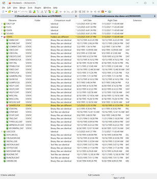

I used WinMerge on a Windows PC to compare the game installer directories before and after this crash, to find out what had changed. WinMerge points this file out:
238.91 KiB
139 views

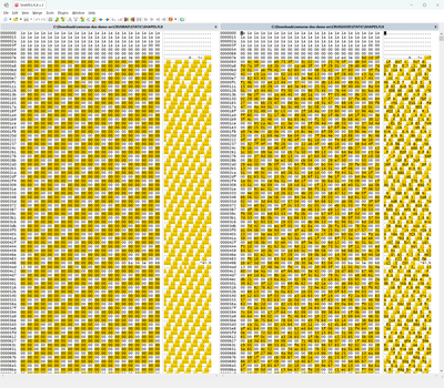

And when binary diffing the file SHAPES.FLX, it looks like the game has zeroed some bytes inside the file:
453.96 KiB
139 views
At this point the source data is bad, and the game demo won't work.

If at any point in time the game startup has failed to a PC hang with black screen, with the brief error message "Unable to open file (null), in file FILE\FASTFLEX.C, line 38." showing on screen, the data files will have gone bad.
